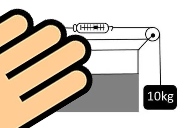

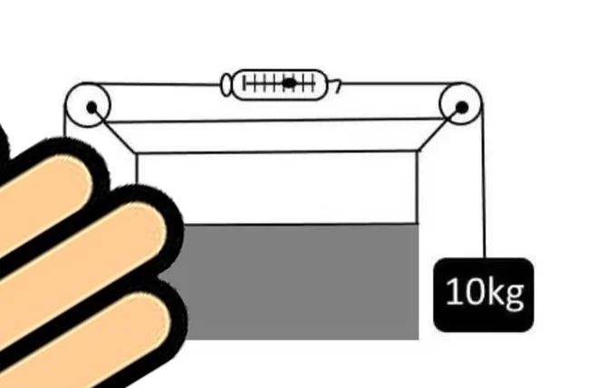

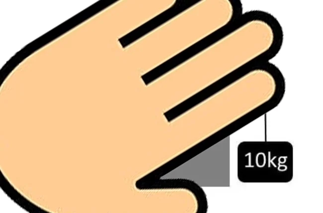

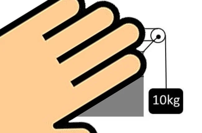

DaveC426913 said:
I'm starting to understand how to inuit the 10kg reading in the scale without resorting to altering the scenario.
We only need to look at one tiny section of the diagram:
A 10kg mass is supported on a string. It is static, meaning something is holding it up else it would fall.
We (i.e. a layperson) can immediately see that any scale above this would read 10kg. The string is under 10kg of tension (100 Newtons, if you wish.)
We expand our scope:
Nothin has changed. Everything is static. String is still under 10kg tension.
We expand again:
Literally nothing has changed. All I've done is show more of the setup.
It must still be under 10kg of tension. And indeed, our spring scale says so.
Again, nothing has changed.
Finally, we reveal what has ensured the string and mass stays static:
Even the layperson will have to acknowledge that merely revealing what is hidden cannot suddenly change the reading on the scale from 10kg to 20kg.
That wasn't quite what I had been appealing for; I'd been appealing for it a single diagram, labeled in such away as to show why it works. But at least the above doesn't require altering the scenario.
I gave you a single diagram showing that, including where there is 20 kg force.

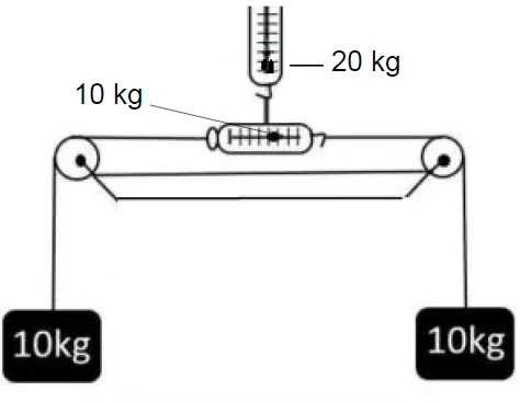

  • #184

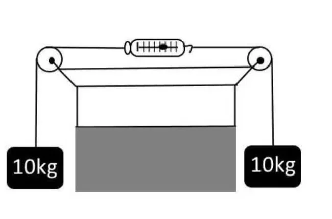

DaveC426913 said:
The only difference here is that I haven't resorted to an alternate diagram/scenario to explain the principle; I wanted to remain entirely with the original diagram/scenario.
Refer to the original diagram in post #1.
Fact: The hanging mass on the left is and remains at rest. This means that the tension in the string to which it is attached is equal the weight.
Fact: The hanging mass on the right is and remains at rest. This means that the tension in the string to which it is attached is equal the weight.
Fact: The pulleys are assumed to be ideal. This means they change the direction of the tension at each side but do not affect its magnitude.
Conclusion from the facts above: The tension at each side of the scale is equal to the weight of a mass.
Answer to original question: Spring masses are designed to display one of the equal and opposite tensions applied at their ends*. Therefore, the reading on the scale is the weight of one of the masses.
*How do we know that? Simple logic. In order to measure a force with a gadget, we need to exert the unknown force on the gadget, but we don't want the gadget to accelerate. Therefore, we need to apply an equal and opposite "stopper" force to keep the gadget at rest. However, that second force does not count. Only the unknown force counts and that's what the gadget displays. In your original diagram one of the weights is being measured and the other serves as the "stopper" force. Obviously, it doesn't matter which is which.

DaveC426913 said:
Yes. We take for granted that things hang, and that the ceiling exerts its own force.
We do take it for granted. Everybody should agree that there is a stopping force behind the screen the prevents the weight on the left from falling down.
A stopping force is a stopping force. It makes no difference if the other end of the string is (a) attached to a rigid wall, (b) is held by Bob hiding behind the screen, (c) goes over another pulley and is tied to the floor or (d) goes over another pulley to another 10 kg hanging mass.
That's what should be pointed out to anyone who is unsure. If they are still unsure, it is worth asking them whether they believe that, when any of (a) - (c) above is surreptitiously replaced by (d) behind the screen, they will see a jump in the reading of scale. Those who do are laboring under a faulty logic based on their everyday observation of spring scales. It's probably something like this.
If I place 6 lbs of bananas in the tray of a vertical spring scale attached to the ceiling, the reading is 6 lbs.
Therefore, the scale reads the weight of whatever is hanging at the free end.
I am now asked what the scale will read in the double hanging bananas picture as shown on the right.
Probable faulty reasoning
  1. I have established that the spring scale reads the hanging weight.
  2. Here we have have gravity pulling at twice the weight.
  3. Therefore the scale reads twice the weight.
The fault lies in not recognizing that both ends of the scale need to be included in what has been established.
Correct reasoning that a layperson should be able to understand (if not construct)
  1. I have established that the spring scale reads weight hanging from one end when the other end is supported by the ceiling.
  2. Here we have gravity pulling at twice the weight, but there is no ceiling. Nevertheless, the hanging masses are at rest. If there is no ceiling, what keeps the masses at rest?
  3. (Aha moment) This picture would be the same as the single hanging mass picture if one of the hanging weights assumes the function of the missing ceiling and supports the other hanging mass.
  4. Therefore, the scale reads the weight of either one of the hanging masses.
A physicist would call step 3 "modeling the double-pulley, double-hanging-mass system as an equivalent single mass hanging from the ceiling."
