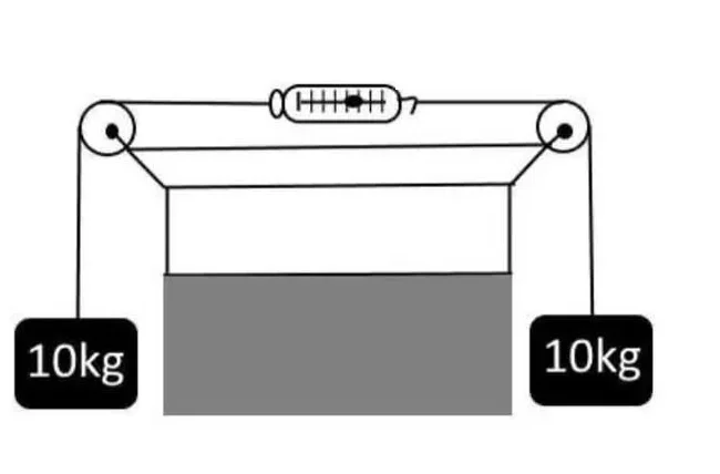

  • #93
russ_watters said:
I'm not a physics professor: is the answer the upwards gravitational force the book exerts on the Earth?
Yes.
And for those interested about that normal force, it's an upward force exerted on the book by the table, so its 3rd Law partner is the downward force exerted on the table by the book.
  • #94
renormalize said:
Can you expand on this by stating the correct answer?
See Post #93.
  • #95
DaveC426913 said:
I didn't see this. So what do the scales read?
10 kg.

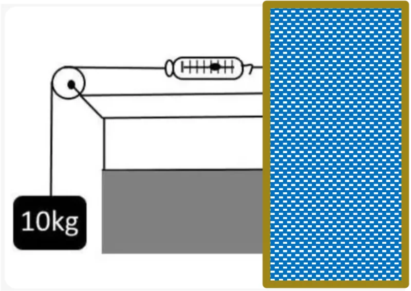

What's the matter? This whole thread is about the fact that a standard spring scale needs two forces of magnitude F pulling on each side, in order to indicate F. So the fact that you omitted one of those forces in your 'correct' diagram is quite telling.

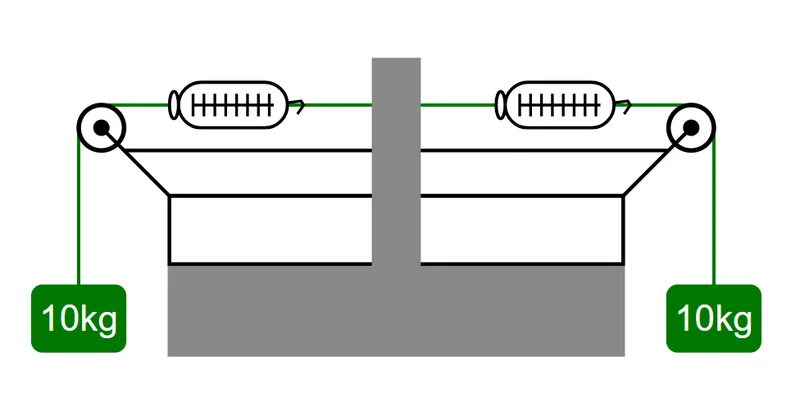

  • #98
Mister T said:
10 kg.
So, if I blew out the centre wall and tied the two strings to each other, they'd still read 10kg each.
And then if I bridged one of them with a taut piece of string, then cut out the scale, the remaining one would still read 10kg.
Which is fine.
I just find it hard to believe the original diagram must be altered to a different scenario in order for the problem to be answered. If this diagram were presented on an exam, I doubt any of these long "look at it this other way" scenarios would cut it.
  • #99
All the scenarios are the same, including the original. A string or spring under tension T means each element has a pair of Newtonian opposing forces on each end - right end of one element pulls with force T on left end of next, and left end of next pulls on right element of first. This state exists all along the string/spring under tension. To avoid snap back, each final end element must have force T applied to it - else it will snap back. Any method of providing that force T on each end is equivalent: holding with your hand, glueing to massive body, rocket, counterweight, etc.
There is no changing of scenario with respect to the string/spring.

  • #101
DaveC426913 said:
What I don't seem to see is a formal solution of the initial scenario that does not involve an altered scenario along with a long intuitive explanation.
It isn't an intuitive thing. It's that the question of how the scale is labelled is arbitrary (edit: or perhaps "conventional" is a better word than arbitrary). It could be labelled in anything, or it could be labelled incorrectly.
So you can show analytically (as has been done several times) that the scale has a 100N force on each end. But the only way you can say that "therefore the scale should read 100N" is by arguing that a 100N force on each end of the scale is exactly the circumstance that you want the scale to read 100N (or 10kg) for its usual purpose of weighing stuff.

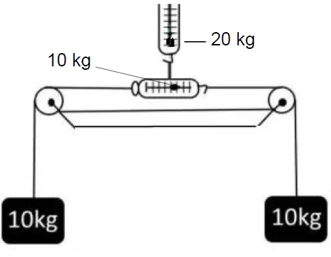

  • #102
DaveC426913 said:
But what is a more elegant way of getting the answer?
Consider the drawing shown on the right.
  • The tension in the left string is equal to the weight, T = 100 N because the mass is at rest.
  • Likewise, the tension in the right string is T = 100 N.
  • The pulleys are ideal meaning that they change the direction of the tension without affecting its magnitude.
  • Therefore the tension on each side of the spring scale is 100 N as shown.
The gist of your question is what does the spring scale read when it is at rest and a matched pair of equal and opposite forces F act on each end?
Well, if no forces act on the spring it does not stretch. If a matched pair of forces ##F## act on the spring and it stretches by amount ##x##, the force ##kx## exerted by the spring on the strings attached to either of its ends must be equal to that force F otherwise the end will accelerate. This allows calibration markings to be put on the scale so that spring displacements in units of length can be read directly as units of force.
The answer then to your question is, the spring scale, when at rest, reads the value of the force F exerted on one of its ends. A spring bathroom scale works the same way except that, here, the spring is compressed instead of stretched. There are two forces acting in opposite directions on the scale, the person's weight ##W## and the normal force ##N## from the floor.
I don't know if this is an "elegant" explanation, but it's simple.

Can you please elaborate for us the broken intuition that you need fixed? Why does your intuition hold that the forces on the two ends of a scale should add to produce the scale reading?

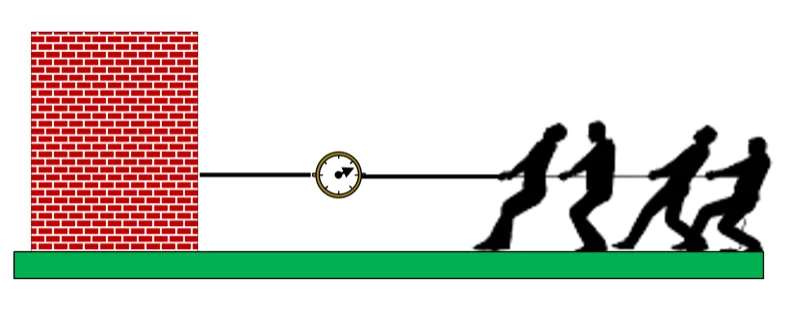

Mister T said:
I just don't understand why you continue to insist that it doesn't make sense. In every case forces of magnitude ##F## are applied in opposite directions to a force-measuring device that then reads ##F##. That's the way spring scales and all other force-measuring devices are designed to work. They are engineered to work that way, by choice.
I completely agree. If you have a force measuring device with two strings attached to it on either end, it's only useful if the tensions in the strings were equal else it will accelerate. Given then that it's not accelerating, the obvious reading for it to display is the value of the tension on either end so that you can hang it from the ceiling and find the weight of a bunch of bananas.

When you have these two forces acting on the scale in this way, the scale reads 100 N, by definition, design, engineering, and convention. Or in this case, in the no-longer-officially-sanctioned unit of kilogram-force, 10 kg.

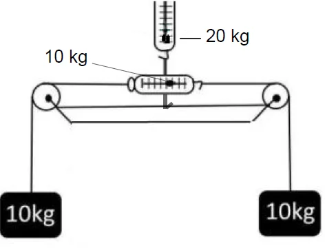

Oh fer cryin out loud the scales are hanging from the ceiling.
