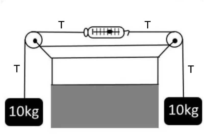

  • #61
vela said:
Here are two free-body diagrams of the scale. One for your scenario (left) and one for the scale suspended from the ceiling (right). As you said, the scale hanging from the ceiling will read 10 kg or 100 N.
Oh. I see.
And now I see why it has to be in Newtons, rather than in kg. The right diagram wouldn't make sense in kg.
  • #62
DaveC426913 said:
3. What I have been asking for is - not any more explanations - but a labeled FBD (or merely a mathematical solution) that results in 10kg.
You are looking for the wrong thing. The problem is with your intuition. The way to fix it is to fix the intuition.
We already have drawings. More drawings or labelled free body diagrams will not help. Nor will mathematics help without a definition for tension first.
We need to attack the intuition that thinks that two opposing momentum flows add to produce tension. They don't.

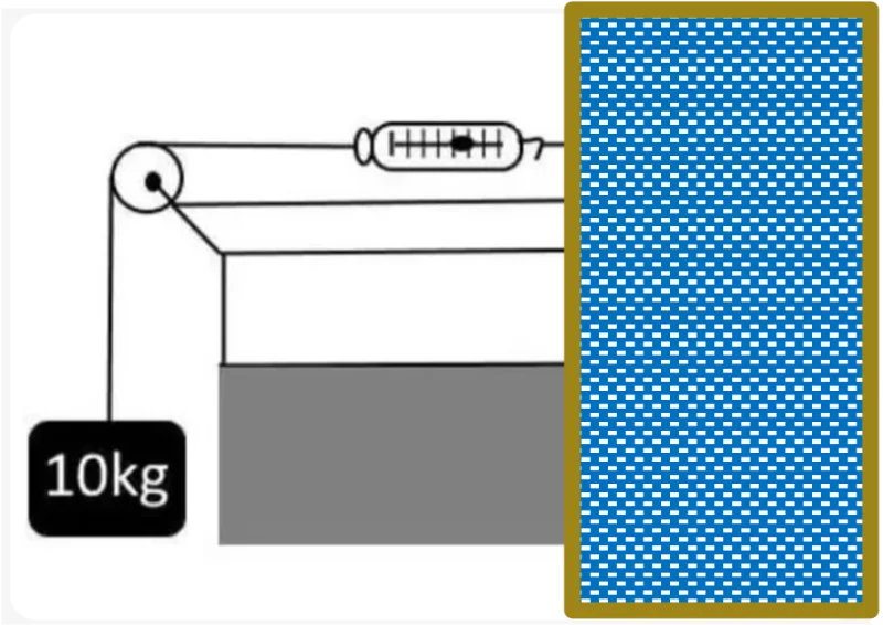

Your logic was fine from the beginning, so the question is how to make it more formal.
Since there is no net torque on the pulleys, couldn't you just make an FBD diagram as your first post described, freezing one pulley and ignoring the weight on that side?
PS. I really don't see anything too informal in your original post, I am not trained in these things.

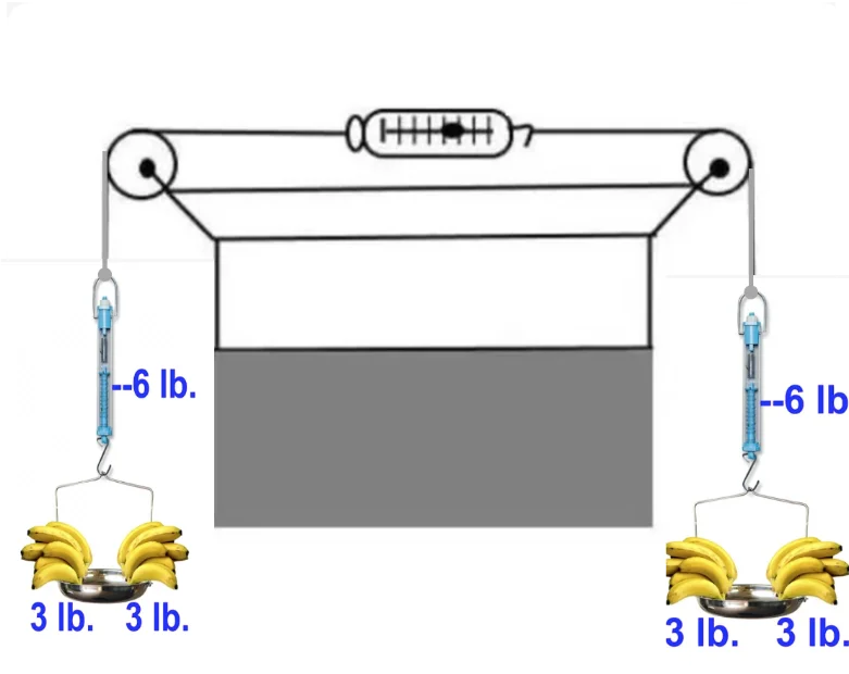

Going with this idea, consider two rockets with equal thrust pulling on both end of a string. This presents the same ‘seeming’ conundrum. Replace one rocket with the string attached to a post a you readily see that the tension is equal to the force by one rocket. Replace the tied end with a rocket and somehow you want to add forces. This does seem to be the key false intuition.
  • #67
Yes.
Now, can you demonstrate that in one diagram, without resorting to altering the scenario (the string) and then explaining that one?

The tension in the string is the result of one end fixed and the other end under force. The nature of the fixing of one end is irrelevant - whether it is a rocket, glue, or a knot.
All three simply apply the force needed to prevent the string from moving.

  • #71
DaveC426913 said:
I can intuit the answer but I can't formalize it.
So far nobody formalized it, so let it be me. Let me denote the mass on the left as ##m_1## and the mass on the right as ##m_2##. The corresponding gravitational potential energies are
$$V_1=m_1gz_1, \;\;\; V_2=m_2gz_2$$
where ##z## is the vertical position coordinate. The potential energy of the elastic spring is
$$V_{\rm spring}=\frac{k}{2}(L-L_0)^2$$
where ##L## is the length of the spring and ##L_0## is its length when no external forces act on it. Since ##L=const-z_1-z_2##, the total potential energy is the sum of all three potential energies
$$V=m_1gz_1 + m_2gz_2 + \frac{k}{2}(-z_1-z_2+c)^2$$
where ##c## is a constant. The forces on the first and the second weight are ##-\partial V/\partial z_1## and ##-\partial V/\partial z_2##, respectively. In the static case they vanish, so
$$ \frac{\partial V}{\partial z_1} = m_1g -k(-z_1-z_2+c)=0$$
$$ \frac{\partial V}{\partial z_2} = m_2g -k(-z_1-z_2+c)=0$$
Both equations can be simultaneously satisfied only if ##m_1=m_2##. In that case the two equations are equivalent, leading to
$$c-z_1-z_2=m_1g/k=m_2g/k$$
We see that the total elongation ##c-z_1-z_2## of the spring is as if only one of the weights with mass ##m_1## or ##m_2## was stretching it.

Here is the formal solution: All is static
Draw a free body diagram for the hook. There are two forces on the hook, the Tension in the string and the spring force ( as indicated on the scale.....that's why it is called a scale)
Draw a free body diagram for the connected mass. There are two forces on the mass F=mg and Tension.
Because all is static the forces on each body sum to zero: mg=T and F_scale=T Therefore F_scale=mg

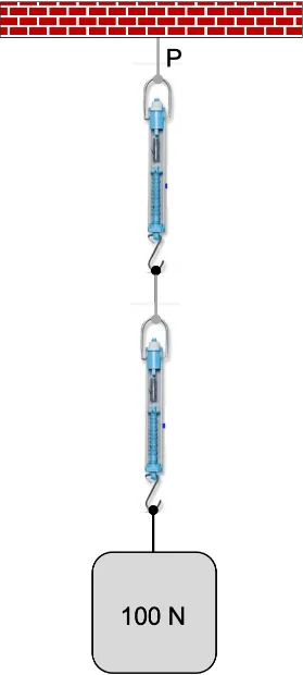

Are they? With the scales attached to nothing on top?
They would be correct, if you had the same but opposite forces F at both ends of the scale that also shows F. The same your horizontal scale with pulleys.
How would you "formalize" the result for this simple vertical scale hanging from the ceiling? The same applies to your horizontal scale with pulleys.
