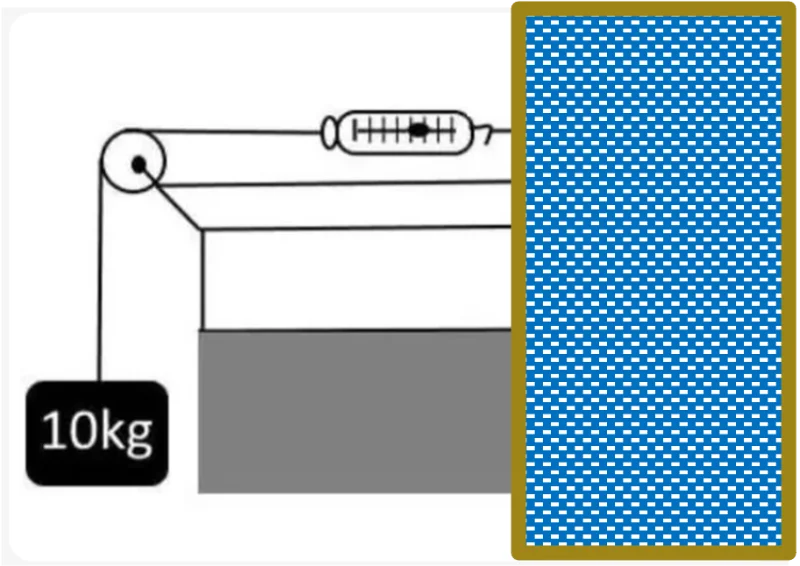

Suppose I asked you to answer the following binary choice question.
The figure on the right shows a 10 kg hanging mass connected to a spring scale by a string going over an ideal pulley. The system is at equilibrium. A screen hides what's beyond the scale to the right.
What does the scale read?
(A) 10 kg
(B) It depends on my knowing what's behind the screen.
What would your answer be? You have no other choices; only one is correct and makes sense.

  • #147
kuruman said:
View attachment 363732Suppose I asked you to answer the following binary choice question.
(A) 10 kg
Yup. I know exactly what you mean. I often use the "opaque screen" technique to help people understand things too.
there's a million ways to explain it. But that's still not really a solution like you might see on a test.

I see a diagram with two 10kg weights being pulled down by gravity on a single scale, I intuit the scale is going to read 20kg. It is very hard to break that conclusion without resorting to an alteration of the scenario.
  • #149
That's just a misunderstanding of how springs work. If the tension in a spring is T, the spring exerts a force of size T on anything attached to it. It pulls whatever is on one side with a force T, and whatever is on the other side with a force T. And a scale is a spring: the number you see is the tension (divided by ##g##, if it's calibrated to display units of mass).
  • #150
The solution to what problem? This question probes whether one knows and understands the context of a spring scale's reading. Here it is: If I cut a piece of string under tension and attach a spring scale end at each cut end of the string, the spring scale will read the local tension in the string.
If I asked the original question in post #1 on a test, I would give full credit to any student who first establishes that the tension in the string without the scale in line is 100 N and then argues that since the spring scale measures the local tension in the string, the reading would be 100 N or 10 kg depending on the scale calibration. This answer shows an understanding of statics and what the reading of the spring scale means.
What more is there to say in a solution?
BTW, the context of an ammeter reading is similar to that of a spring scale: If I cut a piece of wire in which there is a current and attach an ideal ammeter terminal at each cut end of the wire, the ammeter will read the local current in the wire.
