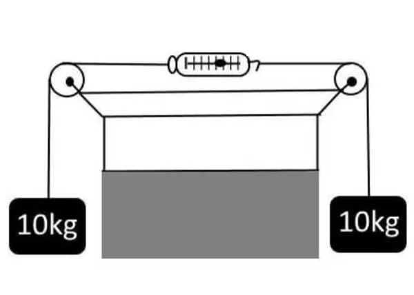

DaveC426913 said:
TL;DR Summary: What does the scale read in this diagram?
My learning is a bit rusty. I can intuit the answer but I can't formalize it.
What does the scale read?
I say the scale reads 10kg.
My logic is this:
  1. Fix the left cable and pulley in place with a giant glob of glue.
  2. Cut the cable holding the left weight.
  3. The scale is holding up a 10kg weight. Nothing has changed as far as the scale is concerned.
But what is a more elegant way of getting the answer?
Is this like the same type of thing where you have a car crash into a stationary car at 10 m/s, then have both cars travel at 10 m/s towards each other, and the damage is the same as in what Mythbusters did many years ago?
Source:
https://www.wired.com/2010/05/mythbusters-energy-explanation/

  • #178
I'm starting to understand how to intuit the 10kg reading in the scale without resorting to altering the scenario.
We only need to look at one tiny section of the diagram:
A 10kg mass is supported on a string. It is static, meaning something is holding it up else it would fall.
We (i.e. a layperson) can immediately see that any scale above this would read 10kg. The string is under 10kg of tension (100 Newtons, if you wish.)
We expand our scope:
Nothin has changed. Everything is static. String is still under 10kg tension.
We expand again:
Literally nothing has changed. All I've done is show more of the setup.
It must still be under 10kg of tension. And indeed, our spring scale says so.
Again, nothing has changed.
Finally, we reveal what has ensured the string and mass stays static:
Even the layperson will have to acknowledge that merely revealing what is hidden cannot suddenly change the reading on the scale from 10kg to 20kg.
That wasn't quite what I had been appealing for; I'd been appealing for it a single diagram, labeled in such away as to show why it works. But at least the above doesn't require altering the scenario.

If you were in the presence of laypeople, and started insisting "this only works here on Earth" and "you need to be an honorary physicist/engineer/mathematicin" you would get a lot of eyerolling - including from me. :wink:
i.e. it is an unnecessary complication to a very simple scenario.
sophiecentaur said:
. A member of PF, even if he/she is a 'layperson', should make the effort and be an honorary Physicist / Engineer / Mathematician.
But the diagram in post 1 is not aimed at PF members. Everyone here got it right away, of course.
Laypeople do not. But could, if the diagram were labeled in such a way as to make it obvious and inescapable.
  • #180
That's what I was trying to explain to you in Post #7.
