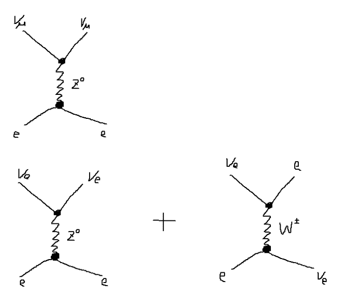

These represent the neutral current scattering for the muon-neutrino and neutral/charged scattering for electron-neutrino. Feynman diagrams are given by
Given that there are 2 possibilities for the electronic case, I say ##R = 2##?
