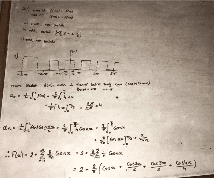

CannonSLX
40
a0=4
an=8/Pi*n
Heres a written solution
https://gyazo.com/57e11d1e7a360914db8aec167beb6b39.png
In the future, please be sure to UPLOAD images rather than use externally hosted links. Here is your solution UPLOADed:
Strictly speaking, your answer for (i)(b) is wrong since you didn't state the period. Note the phrase "of period ##2\pi##" in the problem statement for (ii). It's not a range of values for ##x##. It's a number. What exactly is the definition of the term period?
If you want to check your answer for (ii), just plot the series.
