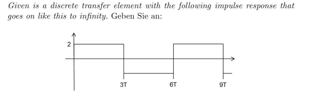

Given is a discrete transfer element with the following impulse response that
goes on like this to innity
N/A
Hey guys, what is the difference equation of the signl seen in the figure ?
my suggestion is: y(k) = 2u(k) + 2u(k-1) + 2u(k-2) - y(k-6)
The term ##y(k)## appears on both sides of the equation. Try subtracting it out. Does the result make sense?
Ouh, sorry...my fault. i forgot the "k-6"
