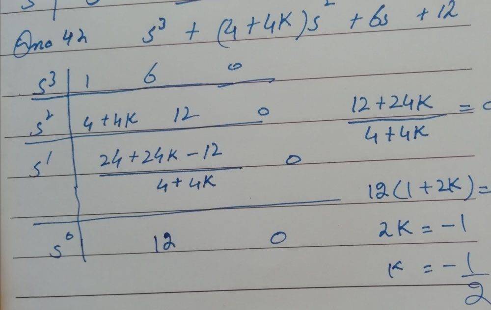

For what value of k does the polynomial shown in picture have roots with negative real parts
Rooth array criteria
See the picture
I am stuck at 12(1+2k)=0
So k=-1/2 for stability k must have value greater the - 1/2 which means there will no sign changes in rooth array and equation represents a stable system

But correct ans is k>-2

First off, the name is Routh. I've never heard of this algorithm, but I found something about Routh-Hurwitz stability at this wiki page - https://en.wikipedia.org/wiki/Routh–Hurwitz_stability_criterion
In the section titled Routh–Hurwitz criterion for second and third order polynomials, it says,
The third-order polynomial
##P ( s ) = s^3 + a_2 s^2 + a_1 s + a_0## has all roots in the open left half plane if and only if
##a_2 , a_0## are positive and ##a_2 a_1 > a_0## .
In your problem, ##a_2 = 4 + 4k, a_1 = 6, a_0 = 12##
The solution to both inequalities is k > -1, so it seems to me that the closest of the given answers is k > -2.
