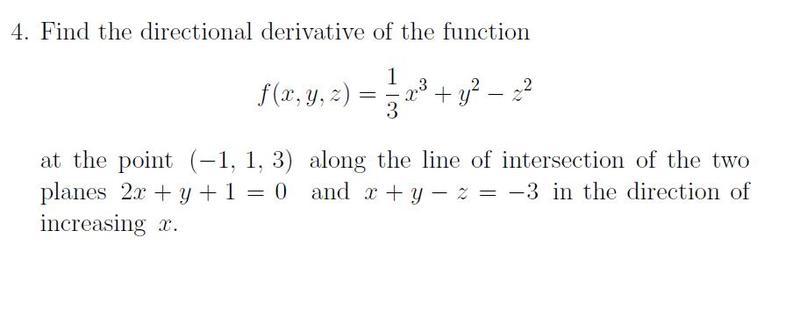

See first figure.

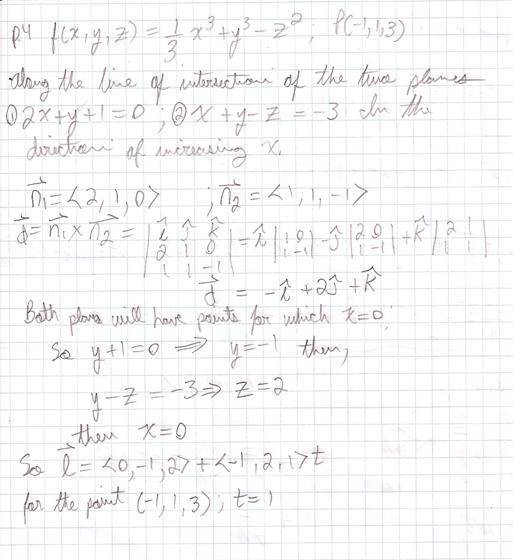

See second figure. I defined direction of the line by which the two planes intersect as,
[tex]\vec{d}[/tex]
and found that the point they are asking about is when,
[tex]t=1[/tex]
and I'm stuck here. This is my first attempt at a question like this so I applogize in advance if I'm missing something obvious.
How do I figure out what direction is the direction of increasing x?
[tex]D_{u^{+}}f(x,y,z) = f_{x}(x,y,z)a + f_{y}(x,y,z)b + f_{z}(x,y,z)c[/tex]
So,
[tex]D_{u^{+}}f(x,y,z) = ax^{2} + b2y -c2z[/tex]
At the point (-1,1,3),
[tex]D_{u^{+}}f(-1,1,3) = a + 2b -6c[/tex]
This is as far as I got.
Any suggestions?

Okay so the line I'm given is as follows,
[tex]\vec{l} = <0, -1, 2> + <-1,2,1>t[/tex]
and for x to increase along the line l,
[tex]t \leq -1[/tex].
so if I simply compute t = -1, I'll get a vector with the direction,
[tex]\vec{u} = <1,-3,1>[/tex]
Scaling this to be a unit vector,
[tex]\hat{u} = \frac{1}{\sqrt{11}}<1,-3,1>[/tex]
Would this be a vector of magnitude 1 pointing in the direction of increasing x?

That's not right. Your [tex]\vec{u}[/tex] is the vector from the origin to the point (1, -3, 1) on line l where t = -1. You want the direction of your line itself for which x is increasing. So you should just have [tex]\vec{u} = <1, -2, -1>.[/tex] Make that into a unit vector and finish up.

Okay so scaling it as a unit vector,
[tex]\hat{u} = \frac{1}{\sqrt{6}} < 1, -2, -1>[/tex]
Now how can I use this to solve for a, b and c? That's what I want to do next right?
No...that's what you just found. [tex]\vec{u} = <a, b, c>[/tex]
Oh okay! I think I get it now.
Thanks again.
Sorry for ressurecting this thread, but I've got another quick question.
When someone asks me for the directional derivative of something at a given point, is my final answer a scalar?
In this case would it simply be the scalar provided by,
[tex]\nabla f(-1,1,3)\cdot \hat{u}[/tex]
Thanks again!
Yes, it's the scalar product of the gradient and a unit vector.
[tex] D_{u}f= \nabla f\cdot\frac{\bold{u}}{\left|\bold{u}\right|}[/tex]
