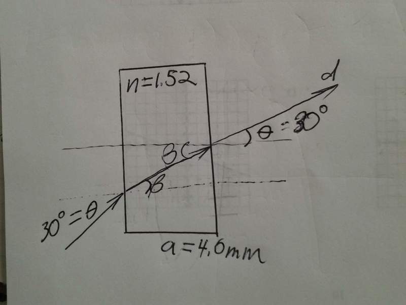

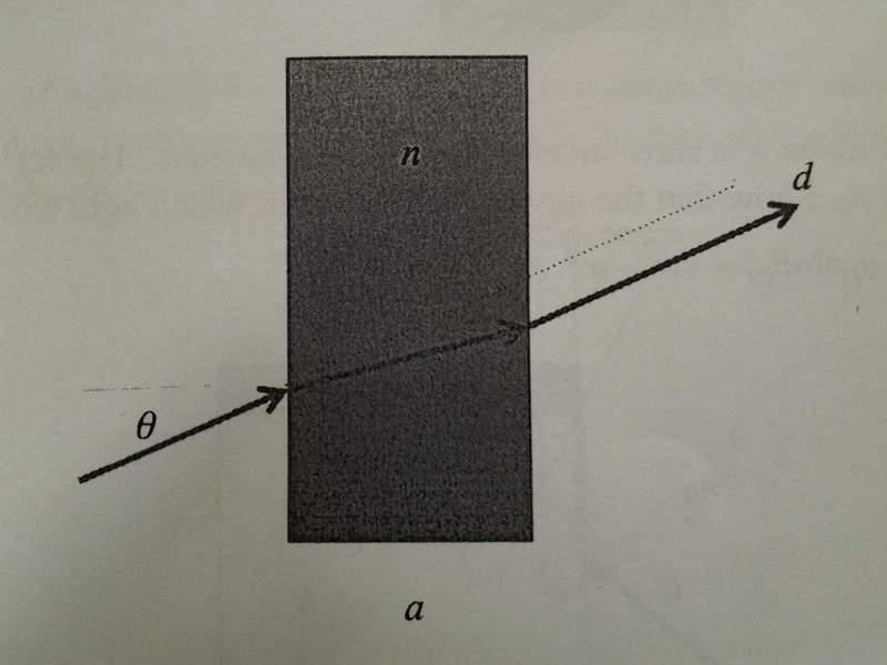

In the following diagram find the distance d if a=4.0 mm, Θ=30°
n_asinΘ_a=n_bsinΘ_b: snells law
a^2+b^2=c^2: pythagorean theorem
I think I got the angle to the problem correct. I am not sure if this is correct. Is this correct Θ_b=sin^-1(1sin30/1.52)?
That will give you the internal angle.
You are apparently required to find the offset distance, d, of the emergent ray.
thank you. How do you find it?

Using geometry. Specifically, the geometry of right-angled triangles.
You start by drawing a large clear diagram, and using a straight-edge to make all your straight lines look straight. Any lines you draw can be made into a side of a right-angled triangle.
okay, I still don't see it.
Where's your diagram?
