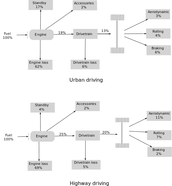

I'm looking for a good figure out there like this to describe electrical vehicles. I know EV's are on average 60% efficient but I'm looking to discuss the losses and percentage loss at the systems in an EV. Anyone have any insight?

yes, only operating energy costs. I guess my question is what are the percentage losses at various systems within an EV like the picture displays above for a conventional vehicle.

I'm not sure what you mean by "60% efficient": all cars are exactly 0% efficient in that they produce zero output work. In other words, if you add up all the losses shown, they should equal 100%.
So to alter those for an electric car, you should change the "engine loss" to what is appropriate (10-20% depending on what you include) and scale up the rest.

The heat engine for EV is whichever steam plant converted the fuel into the electric power that charged the vehicle battery.
87% of US electricity comes from steam plants, coal & natural gas can approach 40% efficient , nukes 30%, combined cycle can approach 50%.
So it might be proper accounting to assign that power plant loss to the EV when you tally up energy efficiency.

If you have 62% in engine loss, you have 38% in non-engine loss. If an EV changes the engine loss to 20%, now you have 80% in non-engine loss. All those losses need to be scaled up by 80/38ths.

I thought I gave a useful answer, but your post implies you don't think so. Maybe you didn't get what I was trying to say (V50 just said the same thing). I'll run through a couple of examples from your first diagram (though not using the same numbers as V50):
My interpretation of "standby" is that's idling, so that goes away completely and your "engine loss" drops to 40% using your 60% electrical efficiency (which seems very low to me, but I'll go with it). So instead of 21% useful power, you have 60%, of which 60/21*2=6% for accessories and 60/21*19=54% delivered to the drivetrain. From the drivetrain, 60/21*13=37% delivered to the axle. I'll let you take it from there.
