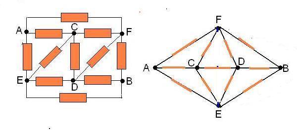

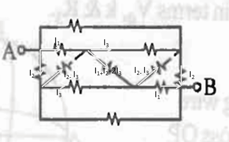

I am stuck at part (a) (i haven't yet tried the part (b)).
I really have no clue on how should i go on finding the equivalent resistance, i don't see a way to reduce it to simpler parallel and series combinations. Any help is appreciated.

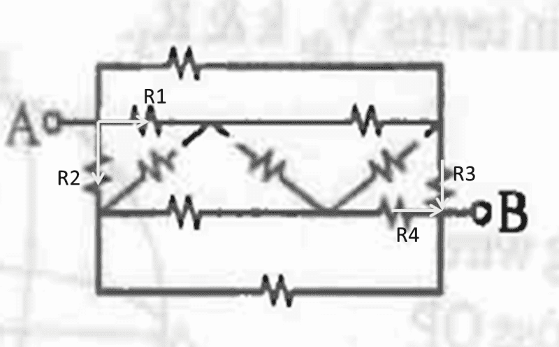

I suppose i should post a pic of what i am thinking, the current in the resistors R1 and R2 should be the same as coming out of R3 and R4 due to symmetry, is that right?
Through each resistor some unknown current Ik flows.
At each node between resistors you have some unknown Vk.
Some of those Ik might be the same due to symmetry.
Some of those Vk might be the same due to symmetry.
Set up a system of equations?

I still don't get it. I can make the equation but i am not sure if i took the right use of symmetry. Can you review the attached pic? I have mentioned the current flowing through each resistor and took use of the symmetry of circuit, is it right?
Your use of symmetry looks overall correct. :)
However, in your leftmost I2-I3 you seem to have ignored the current through the bottom most resistor?
Oops, sorry, i forgot about, i was focusing on the middle part. :P
I think i will have to again label the currents, i haven't sent any current in the topmost resistor too.
Yeah well, if you designate the bottom current, the topmost one will be the same due to symmetry! :)

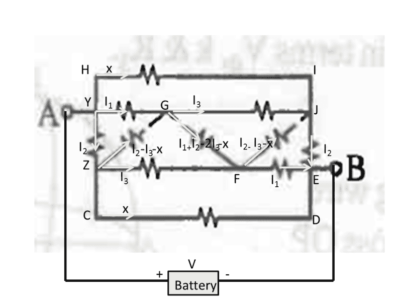

Can you help me finding the right loop please? I have attached the figure with nodes marked.
I attached the battery. I could find one loop useful, AYHIJEBA, from here i get an equation,
V-xR-I2R=0, where x=I-I1-I2.
V=IR+I1R
Now which loop should i select? I am stuck here. :(
EDIT:Sorry, i forgot to mention I in the pic, its the current sent by the battery.
That looks correct! :)
Why would you select a single loop?
Pick any loop you like.
For instance pick the one through the top.
The one through the bottom will be the same, so you can leave that one out.
Now keep picking loops until you have as much variables as you have equations (avoiding those that will duplicate existing equations).

However, when you can't find equivalent resistances using regular parallel or series replacements, you will be stuck with Kirchhoff's laws.

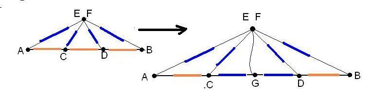

There is a trick: If you find two points in a circuit which are at the same potential you can connect them with a wire, so the two points become a single node.
See the attachment. When connecting a battery between A and B, both E and F are "at the middle" so at the same potential. connect E and F and fold the circuit so E and F become a single node: all pairs (A,F), (C,F), D,F), (B,F) are connected with two resistors in parallel. The orange lines represent R resistance, the blue represent R/2 resistance. The resistor in the middle can be halved, making a new node G. G is at the same potential as the node (EF). You can draw a short between G and (EF), and you have all parallel and series resistors between A and B at the end.

It is not needed, Sammy. The node EF can be connected to point G and all resistors are either series of parallel.
(I hate Δ - Y transform:-p)
ehild.

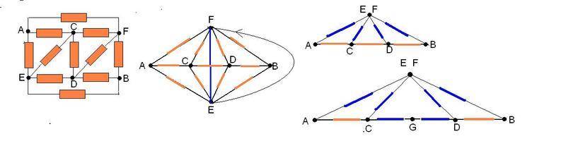

Please explain this, i don't understand how you get this.
Do you understand that the circuit in the first figure is equivalent with the second one?
You can consider a circuit as a graph. There are nodes connected by resistors, the resistors are equivalent by the edges of the graph.
Two graphs are equivalent if both have the same nodes, and the equivalent nodes are connected with the same number of edges.
The second figure is equivalent to the original circuit. (The orange lines represent the resistors)
The symmetry of the circuit is apparent in the second figure. The part left from the line EF is the mirror image of the part on the right. It is also symmetric to the line AB.
If you connect a battery between A and B the voltage drops the same from A to F as from A to E, and again the same from A to F and from F to B, from A to E and from E to B. E and F are at the same potential, and as both are "halfway" between A and B the potential difference VAF =VAE=VFB=VEB=VAB/2
Check your figure with the currents and voltages: You got the same situation.
ehild

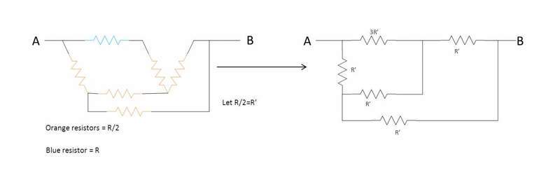

Were you able to come up with a solution for circuit (b) ?
I know its too late to reply to this thread now. I thought instead of creating a new thread, I will complete this one.
Thanks ehild, your trick was really helpful for the first question. :smile:
I gave a try to the second question but got stuck at the last step. The circuit is symmetrical about the line AB so I folded it and transformed it to as shown in the attachment. Now I am unable to proceed ahead. :(
EDIT: I have figured it out. It was easy once I applied the delta-Y transform. Thanks once again. :smile:
