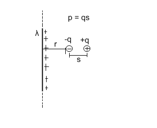

Show that a line of charge density [tex]\lambda[/tex] exerts an attractive force on an electric dipole with magnitude F = [tex]\frac{2\lambda p}{4\pi\epsilon_{0}r^{2}}[/tex]. Assume that r is much larger than the charge separation in the dipole.
I need to show that the magnitude, F = [tex]\frac{2\lambda p}{4\pi\epsilon_{0}r^{2}}[/tex]
p = qs => assume s is very small at end of calculations
F = Fon -q + Fon +q = 0
Fon -q = -qE
Fon +q = +qE
I am not sure if I am doing this correct?
F = Fon -q + Fon +q
F = -qE + +qE
= [tex]\frac{pE}{s} + \frac{pE}{s}[/tex]
= [tex]\frac{p}{s}\frac{1}{4\pi\epsilon_{0}}\frac{2\lambda}{r} + \frac{p}{s}\frac{1}{4\pi\epsilon_{0}}\frac{2\lambda}{r}[/tex]

There are 2 problems here:
  • A "-" sign got lost from the -qE term, when you went on to the next step.
  • The distance to the +q charge is not r.
Hope that helps. :smile:
