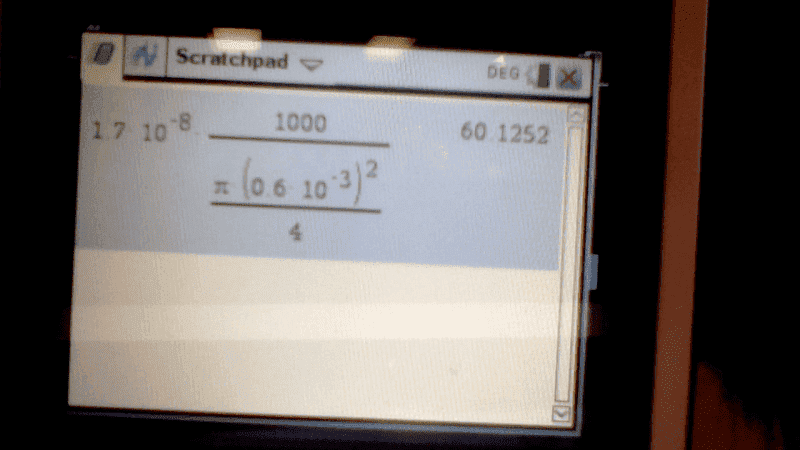

I believe that it's a matter of order of operation (you know, putting parentheses in the proper places). I punched in the values and got 60.1252--which is the correct answer rounded.
How did you do it? Could you post what you typed into the calculator?

That's odd. I did the same thing. This is basic arithmetic, so calculator settings should not really matter. What answer did you get? I see that your calculator is in degrees, but radians vs. degrees doesn't matter here at all. What are you're other settings?

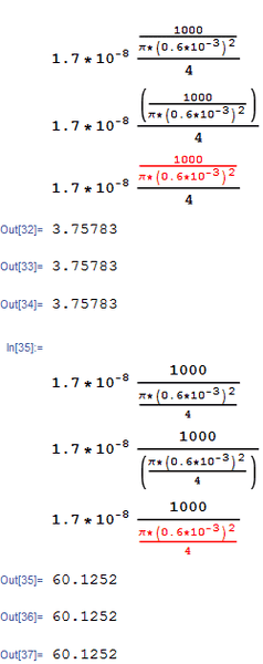

To the OP: In your calculator, you have entered ##R = \rho \frac{(L/\pi D^2)}{4}## instead of ##R = \rho \frac{L}{\pi D^2 / 4}##. Notice that the first one gives ##R = \rho \frac{L}{4 \pi D^2}## and the second one (the correct one) gives ##R = \rho \frac{4L}{\pi D^2}##

Even now Axmls has pointed out your possible error, I can't tell from your calculator display whether you did what he says or whether you put in something else. I can't read it as Axmls does. But he's probably correct, since your answer is a factor of 16 out.
If someone wrote that expression on paper as shown on your screen, I'd say it was wrong, but my reading of it does not give your answer.

When you have an expression with two fraction bars there can be ambiguity as to just what is meant. The order of entering the parts of the expression makes a difference in how it will be evaluated. For example, see this image:
The use of parentheses can remove the ambiguity.
