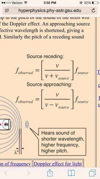

Temperature is 28C, a police car with a siren blazing at 988Hz is coming toward you at 23m/s so you run away at
7m/s.
f=f(v+-o/v+-s)
I'm confuse on the formula.
What specifically is confusing you?

I know how to solve to get the speed of sound but are they moving forward (+) or backward (-) and what's is the observer and source. Is the source the police siren?
Do I use the formula I gave or the one from the picture?
The observer is what detects the sound. The source is what produces the sound the observer hears.

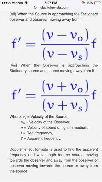

I did have some concerns about the equation you posted previously, but I wanted to see how you applied it. The equations in the image you have attached look fine, except that you should ignore the references to "Stationary" observer. That makes no sense given the rest of the text. It's probably a cut-and-paste error from some preceding cases.
So, which of the two cases in the image do you think applies here? What do you get when you apply it?

f= f(v-o/v-s)
I got 1036.64Hz
ThePhysicsXV said:
f= f(v-o/v-s)
I got 1036.64Hz
I get the same. Round that to the appropriate number of digits.
