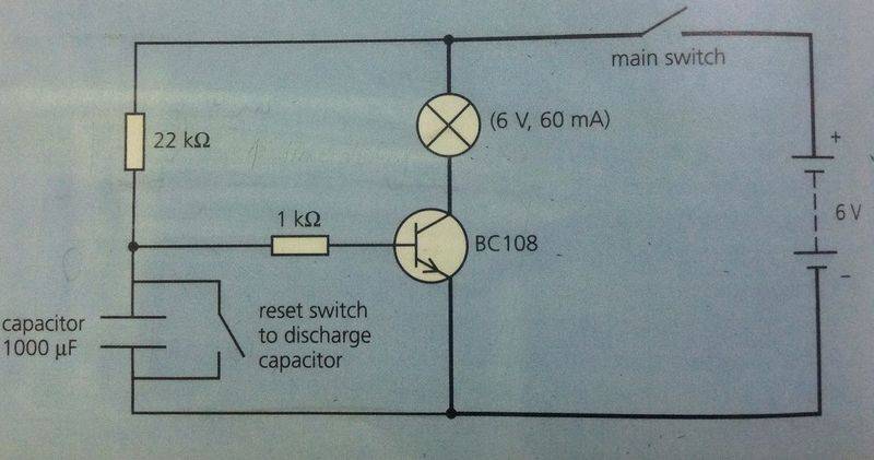

What is the importance of the upper resistor in this circuit

The book also says you can increase the time delay by increasing the resistance of the upper resistor , why, what does it do?
uploading images
You need to study basic RC circuits. Think about this circuit with nothing but the upper resistor and the capacitor/switch pair (and a voltage applied across the two in series. What does this circuit do?
increasing the value of the upper resistor ( the one currently marked 22k) decreases the current flow to the capacitor
and therefore the capacitor takes longer to charge up
Dave
Ok the explanation is clear. Thank you very much.
