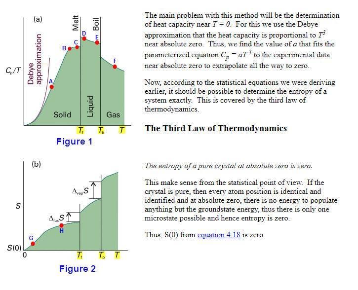

Hi,
Could you please help me to clarify a few points to understand entropy intuitively?

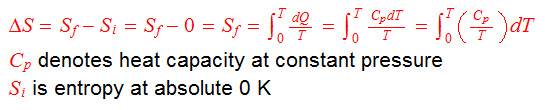

Entropy is defined as:
Please have a look at the attachment, "entropy111".
Source of attachment: http://faculty.chem.queensu.ca/people/faculty/mombourquette/chem221/4_secondthirdlaws/SecondLaw.asp
The attachment shows how entropy is calculated for a substance. Figure 1 shows the plot of Cp/T against T and Figure 2 shows the plot of integral ∫(Cp/T)dt from 0 K to 'T' K, i.e. ΔS, entropy. I would say that the plots shown relate closely to those of many real substances.
Question 1:
In Figure 1, the heat capacity, Cp, is less at 'A' compared to at point 'B', while the value of Cp at points 'B' and 'C' is almost equal.
i: Why does Cp become almost constant between 'B' and 'C'?
ii: Between Tf and Tb or between 'D' and 'E', Cp decreases. What could be the reason for this?
iii: Between Tb and T, Cp again decreases drastically. It simply means that less energy is required to raise the temperature by 1 K.

In Figure 2, the entropy is changing at a faster rate at point 'G' than at point 'H'. Do I have it correct?

Q1: What is the y-axis of Figure 1?
Q2: Yes
Q3: Can you find Cp of air? Does this help you?
Thank you!
It's Cp/T where 'T' is a constant therefore Cp should vary, i.e. it's a variable, as the plot shows.
Actually in simple terms, my question was that what factors could affect Cp in different phases of a substance as shown.

Is T a constant? T is the x-axis variable, so it is varying.
Cp/T = dS/dT, so you integrate the top curve to get the bottom one (including ΔS for phase transitions).

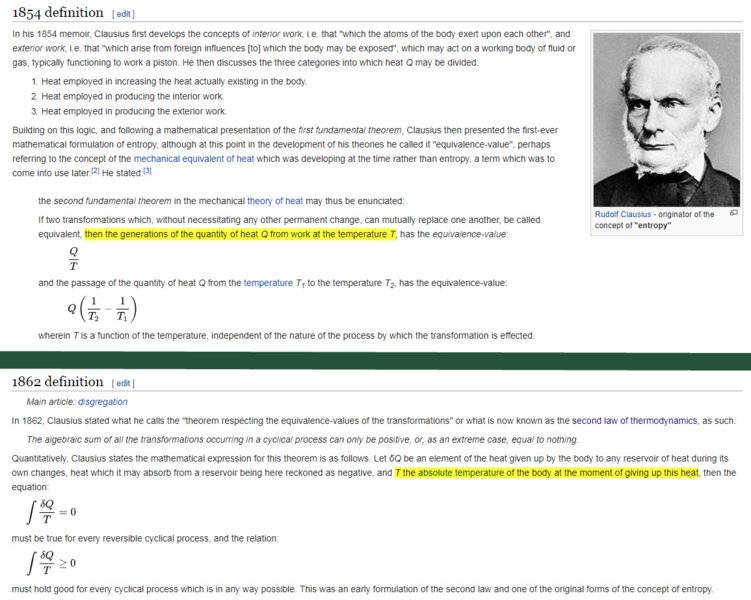

I had always thought that 'T' is the temperature at which entropy is being found therefore a constant value. If we assume that entropy is actually found the way shown in the plot then if the entropy is being calculated at 25 °C, it will make T=25 °C. So, please correct me. For example, I had always thought that 'T' in the highlights of attachment 'entropy141' represents the temperature at which heat transfer process starts. (For better resolution please see this link https://imageshack.com/a/img923/665/Wse71G.jpg). But obviously as the transfer of heat takes place, with every dQ quantity of heat, there would be a corresponding dT fall or rise in value of temperature.

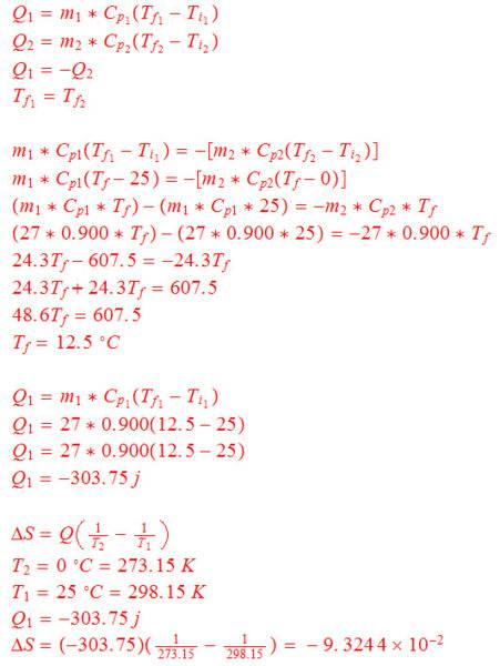

For my other question, I tried to work it out.
specific heat capacity of aluminum 0.900 at 25°C in J/g⋅°C
mass of each block is 27 grams
grams = number of moles * molar mass
atomic mass of aluminum 27 therefore for aluminum, grams = 1 * 27/1 mole = 27
Q=Cp*ΔT
I think that ΔS part is wrong because I didn't really know what I was doing!

T1 and T2 are wrong for the cold block. In any case your equation is the wrong one. Q(1/T2 - 1/T1) applies to transferring an amount of heat Q from a body at a constant temperature of T1 to one at a constant temperature T2. In your example the temperatures of the blocks are changing. Therefore you need to integrate the equation dS = (Cp/T)dT just as in the very first equation you posted (except from T1 to T2, not 0 to T).

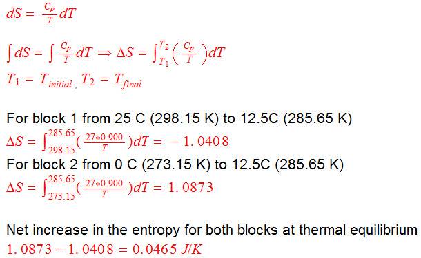

No. The correct exact result is $$\Delta S_1=(27)(0.9)\ln{(285.65/298.15)}=-1.0408$$
$$\Delta S_1=(27)(0.9)\ln{(285.65/273.15)}=+1.0873$$
So the combined change in entropy is 0.0466 J/C
The average temperatures for the hot and cold blocks would have been 18.75 C and 6.25 C. If you had approximated the entropy changes using these temperatures, you would have obtained:$$\Delta S_1=-\frac{303.75}{291.9}=-1.0406$$$$\Delta S_2=+\frac{303.75}{279.4}=1.0872$$So, with this approximation, the combined entropy change would 0.0466 J/C. So, in this case, the approximation using the average temperature would be pretty close to the exact result.
I corrected it.
Anyway, the correct calculation is shown below.
I understand that it would be an isothermic process but I can't think of any particular one. Could you please give an example of one?
@Chestermiller, thanks a lot for showing your calculation; the one with average temperature was helpful to see it differently.

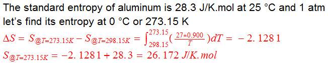

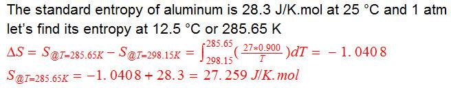

Also, I found the entropy values at 0 C and 12.5 C.
@0 °C
@12.5 °C
This shows how entropy values at three different temperatures relate to each other.
What you are trying to do here is determine the change in entropy of the hot block from 25 C to 12.5 C. To make this calculation, you must devise a reversible path between the initial state and the final state, and calculate the integral of dq/T along that path. This can't be done with just a single constant temperature reservoir. You need to use a sequence of reservoirs at temperatures running from 25 C to 12.5 C. Then you transfer a tiny amount of the heat from the block to each of the reservoirs. As the number of reservoirs becomes infinite, you approach the integral of ##C_pdT/T##.
You do a similar thing for the cold reservoir running from 0 C to 12.5 C.

PainterGuy said:
Thank you!
I understand that it must be really important and thanks for making it more clear. The point I was trying to make using those examples was that those 'standard' examples among some others which are used almost everywhere to introduce the concept of entropy are not really good ones because they make to seem the entropy concept a little superfluous, in my opinion at least; the reason being that all those phenomena could easily be explained independently of entropy. Do you know of any other example(s) which really emphasize the importance of entropy by showing how the explanation of phenomenon become somewhat difficult and clumsy without the use of entropy? Thanks for your help!
I'm only able to cite the examples from my area of expertise. In my area, it would have been very difficult to establish the importance of entropy to chemical equilibrium thermodynamics before introducing its more elementary derivation. It wasn't until we learned about multicomponent phase- and chemical equilibrium did its real power revealed itself to me.
