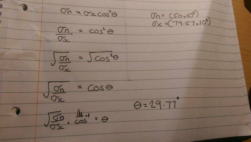

Not sure if I'm doing this right. I have an angle theta to find but the cosine has been squared. I brought over inverse cosine to multiply to leave theta on its own. I was told the answer should be closer to 37 degrees? Am I doing something wrong here?
Did you calculate it via
arccos(sqrt(50/79.57) ?
On the 4th line from the bottom you have ##\frac{\sigma_n}{\sigma_x} = \cos^2(\theta)##
This is equivalent to ##\cos(\theta) = \pm \sqrt{\frac{\sigma_n}{\sigma_x}}##
If you take the inverse cosine of both sides, you can isolate ##\theta##. You are NOT multiplying by inverse cosine to get this.
There are many values of ##\theta## that satisfy the last equation above. One that I get is around 37.6°. Please show us the calculation you did.

Remember the notation ##cos^{-1}(\theta)## is not the same as ##1/cos(\theta)##.

Thanks for helping I worked it out as the same 37.56 degrees, my maths is a little rusty at the moment!

Keep in mind that +/-. There's another value around 142°.
