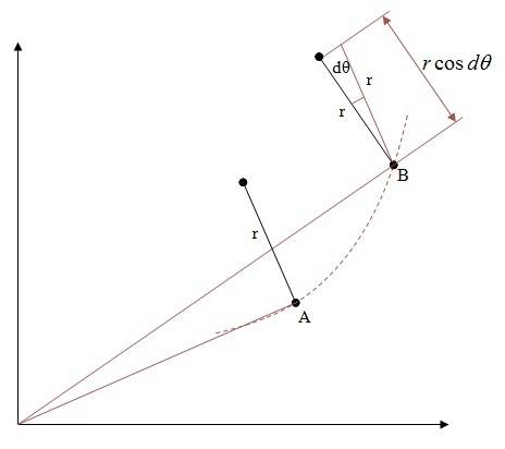

Karol said:
I need the component of ##\vec{a}_{c/p}## that's vertical to the rope, that's in the direction of ##\vec{e_\theta}##
View attachment 89816 i copy r parallel to itself from point A to B. the CM has rotated ##d\theta## . the vertical change of CM is ##r(1-\cos\theta)## and if i take the derivative i don't get the third member ##r\dot\theta^2##.
I'm not following what you did there. The center, c, of the wheel is always at a fixed distance, r, from the moving point p. So the only motion that c can have relative to p is circular motion about p. Thus, the acceleration of c relative to p can be thought of as having a centripetal component (towards p) and a tangential component (tangent to the circular path of c relative to p). Which of these components is perpendicular to the string?
  • #32
The centripetal component is perpendicular to the string: ##a_{\bot}=r\dot\theta^2##
  • #33
Yes, good.
