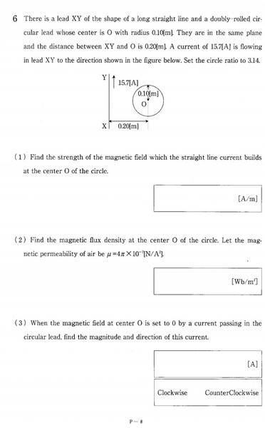

What is the Magnetic Field and Flux at Point O?
29 replies · 3K views
Helly123
581
[/B]
There is lead XY shaped as straight wire. Next to it, circular lead with radius 0.10 m.
They are in the same plane.
XY to center of circle, O is 0.20 m.
Curent flowing through XY is 15.7 A
1) find magnetic field (B) at O[/B]
B induced by XY at O ##u_0##I/2##\pi##r
B induced by Circle at O ##u_0##I/2R
So i just add both?
Since B induced at O by XY is opposed direction, the current at Circular wire is opposed direction to current XY?
2) flux at O
flux = BA cos ##\theta##
So A is 1? Because it just a point at O?
While, B equal to B at number 1) ?
3) when B at O set to 0 by a current passing in circular lead. Find magnitude and direction of this current
B at O is zero
This current does it refer to current at circular wire?

Could you please restate the problem exactly as given? Looks to me that you have current going through the straight wire and a circular area defined. Are you supposed to find the flux through that area?

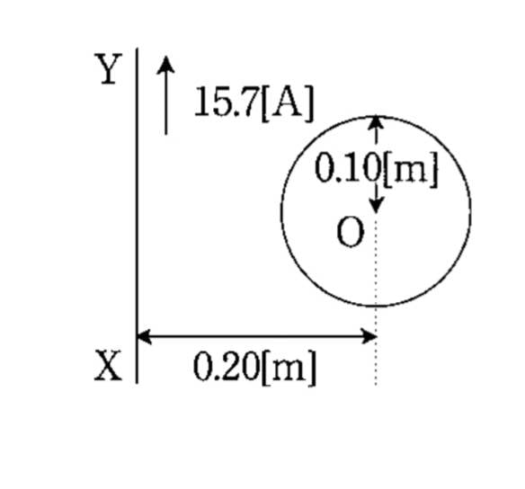

This is it. Hope it shows clear
It only says that, flux at O.
OK, much clearer. For parts 1 & 2 you only need consider the magnetic field generated by the straight wire.

For 1) the formula before is correct?
For 2) i simply count Area as 1?
Ah, it looks like they are distinguishing B (magnetic flux density) from H (magnetic field strength). For this problem, they are simply related. See: Magnetic Field
(I'm too used to calling B the magnetic field strength, as done in most elementary books.)

For number 1) i have to find H = 1.25 A/m
For number 2) i have to find B = 1.57 10^-6 Wb/m^2
As for number 3.
1.25 A/m
How many meter to be counted for that circular wire? How to tell that the induced current have opposite direction to current XY?

You need to know how to find the field at the center of a current loop.
You'd use a version of the right-hand rule. For example, a clockwise current in that circular loop would produce a field (at the center) going into the page.
You know the direction of the field from the straight wire (from another version of the right-hand rule) so the field from the current loop must oppose that direction to cancel it.

Field from straight wire XY is 1.57 10^-5 Wb/m2
B at loop = ##u_o## I/2R
1.57 10^-5 Wb/m2 =( 4##\pi## 10^-7 • I ) / 2(0.1)
I = 2.5 A

One thing that could explain the discrepancy: They refer to the loop as "doubly-rolled". Does that mean it's really two loops? (Which would make the required current half as much.)
Yes. I think so. So it makes the current flow is 1.25 A for each loop?
Right. (It's one current going through both turns of wire.)
