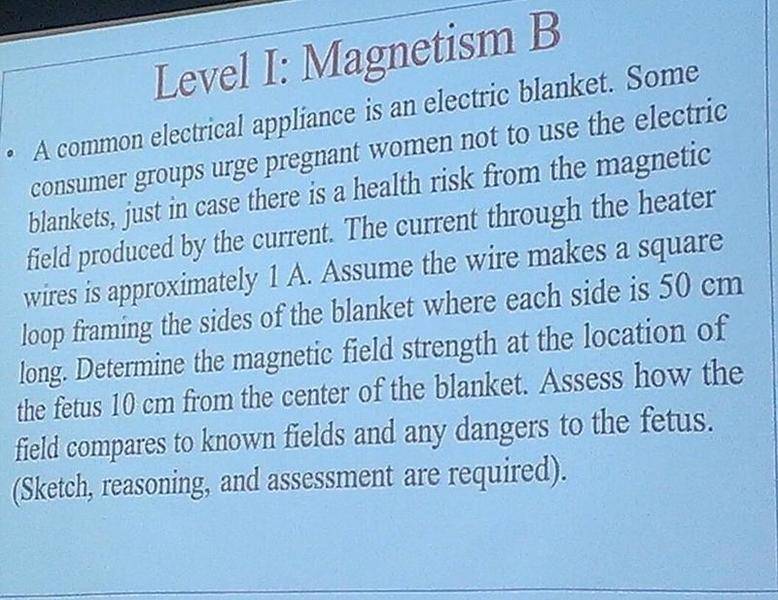

1. Problem statement.
2. Known equations
Biot-savart law
3. Attempt
I believe since I was given a current value already, I can just use the equation
B = IA
with A = 2l + 2w, but I'm having difficulty understanding the "10cm from the center" part, I'm just thinking to pick a spot 10cm from the center because the problem is not telling me any extra directions, if it does need to be at a certain spot, how does that change my answer??

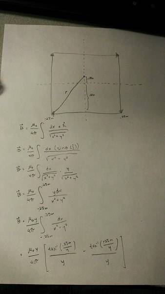

Ok I am kind of seeing what you mean by 3 integrals, so using the diagram Zondrina created and also labeling the middle as the coordinate origin, from that I can see 3 integrals, the integral from the bottom wire, the top wire and the side wires are symmetrical so they count as one.

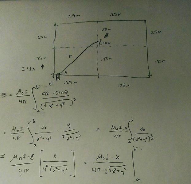

This is my attempt for just the integral from the bottom wire. I want to make sure that is correct first before I continue,
Basically I let dl = dx, I see that for the r-hat part, only the sin part matters since the cos's cancel each other out, set the bounds from -.25m to 25m and y is a constant at .60m and then solve the integral.
You took quite a different approach from what I had in mind, but that's not saying it couldn't be done that way. I put the origin at the "fetus" and did not use an angle in the math.
But your statement of the B/S law is in error. If your Ř is a unit vector (no dimension) as I suspect, the denominator needs to be x2 + y2. If R is a position vector (dimension = L) then the denominator needs to be (x2 + y2)3/2.
I would also leave the i in the coefficient even though i = 1A. This is so you can do dimensional checks later on - a very powerful checking tool.
Your math seems mysterious and unfinished. You can't have any y's in your answer.
Hmm I see what I did wrong, I modified it and got a different integral. Once I substitution in all the values and such, is the method I am using would give me the correct answer? I am thinking I just repeat the integral for each of the wire and sum them all up would give me the magnetic field at that point?

Bounds are from -.25m to .25m, y is .35m

I am still having trouble how the point is equidistant from the wires, since the point we are looking at is above the center, wouldn't it be closer to one side than the other?
I believe the problem wants us to assume the point is 10cm away from the plane of the blanket, not 10cm from the center within the plane of the blanket. If the latter were the case we would need to know more information about where the point is, since there is an entire circle of points 10cm from the center within the plane of the blanket and the field would be different at different points on such a circle. Plus the problem mentions a fetus, I assume if the expectant mother is using the blanket, the fetus would be something like 10cm below the center of the blanket.
I interpret the problem statement in the same way.

From what I see it right now, I think it would just be
B = (μ0) i / 4 (pi) ∫ dx * sinθ / r^2
convert the sin in terms of x and y, and then integrate from -.25m to .25m with y = .10m
