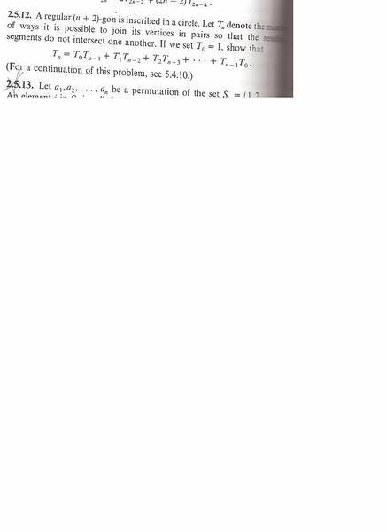

Can someone just explain to me what this problem is asking? The words that got cut off are "number" and "resulting". For example, why T_1 = 1?

The sum is a sum of pairs of numbers, the first of each pair starts at [itex]T_0[[/itex] up to [itex]T_{n-1}[/itex] while the second number goes the other way. For example that formula asserts that [itex]T_1= T_0T_0= 1[/itex] and [itex]T_2= T_0T_1+ T_1T_0=1+ 1= 2[/itex].
[itex]T_1[/itex] is "the number of ways it is possible to join the vertices of a triangle (1+ 2= 3 vertices) in pairs so that they do not intersect each other". We can connect two vertices by drawing a side of the triangle. If we drew another side, it would have to intersect the first at an endpoint so we can draw only one line. [itex]T_2[/itex] would be the number of ways we can connect the vertices of a square so that they do not connect: [itex]T_2= 2[/itex] as the formula said because we can draw to parallel sides that do not connect.
I will agree that the wording, "the number of ways", is misleading. If we have triangle ABC, I would have thought we could have drawn AB and no other side, or BC and no other side, or AC and no other side, giving 3 "ways" but that is clearly not what is intended.
But in the triangle you can join AB, BC, or AC, right? Why are there not three ways?
Yes, that was why I said the phrasing was misleading. Since the three points A, B, and C could be labeled in different ways, so that any side could be labeled "AB", they are not considering those as "different ways" of drawing a line. You can pick anyone of the three sides to draw first- then there are no other lines to be drawn that do not intersect the side already drawn. One way of drawing lines that do not intersec.

So, if I understand this right, it is really the maximum number of non-intersecting line segments that you can draw in the circle each of which joins two vertices, right?
I think that is a much better way of stating the problem!
Wait. T_3 = 5 means that it is possible to draw five such lines, but that is impossible since there are a maximum of two disjoint pairs of vertices--so there can only be two such lines! I mean that in ABCDE, you can take two pairs of letters and draw lines between them, and then there is nothing else you can do since there is only one letter left!

I think the sense of the problem is that you just keep drawing segments until you can't draw any more without crossing another. In the n=3 case (pentagon) you connect the consecutive vertices to get the pentagon and then you can draw two more interior diagonals. However you do this one vertex has four edges attached to it. There are five choices for this vertex, so T_3=5.

No, I would say T_2 (square)=2. Because there are two different internal diagonals to draw. I don't think that's what Halls meant. The vertices are distinguishable. The order in which you choose them to draw isn't.

So, T_1 (triangle) = 1 because there is one way to draw internal vertices i.e. drawing none at all?

Mmm. Maybe we are saying two different things. I was taking it to mean draw without INTERNAL intersections. In which case you can always draw the usual polygon lines for free and then just worry about number of ways to draw the internal lines. I checked that T_4=14 and thought I had counted all of the diagrams correctly. Try it for T_3 and see what you conclude.
