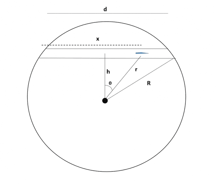

Two cities are connected by a straight underground tunnel, as shown in the diagram. A train starting from rest travels between the two cities powered only by the gravitational force of the Earth, [itex]F = - \frac{mgr}{R}[/itex].
Find the time [itex]t_1[/itex] taken to travel between the two cities (i.e. half the period). The distance between the two cities is d and the radius of the Earth is R. Now, suppose the train is given an initial an initial velocity [itex]v_0[/itex]. What is [itex]v_0[/itex] if the time taken to reach the other end of the tunnel is now [itex]t_2 = \frac{t_1}{2}[/itex].
Hint: Since [itex]t_1 = \frac{T_1}{2}[/itex] that means [itex]t_1 = \frac{1}{2} \frac{2 \pi}{w} = \frac{\pi}{w}[/itex] and therefore [itex]t_2 = \frac{\pi}{2w}[/itex].
I have the answer to this question I just don't know how to do it.

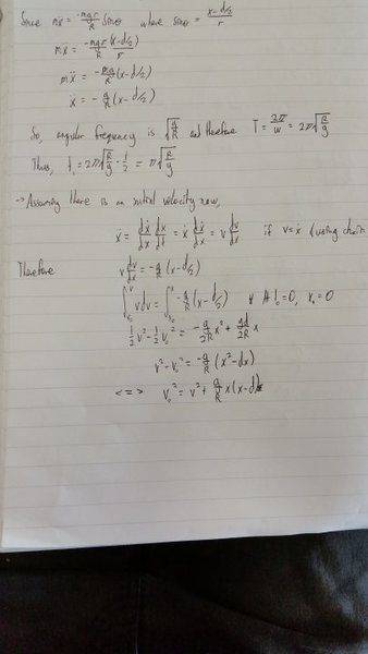

I can get an equation for [itex]v_0[/itex] in terms of x and v but I don't know how to get that in terms of t or if I'm even approaching this the right way.

I can get an equation for [itex]v_0[/itex] in terms of x and v but I don't know how to get that in terms of t or if I'm even approaching this the right way. View attachment 98904
Your picture of your work is very hard to read. Can you type your work into the forum? Have you learned how to use LaTeX here yet? There is a tutorial on it in the Help/How-To section (hover over INFO at the top right of the page). :smile:

Hiya, sorry about that. It wasn't going down the right path so I tried it again below.
