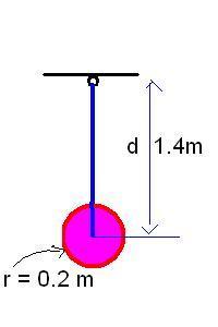

A compound pendulum consists of a thin rod of length 1.4 m and a disc of radius 0.2 m. The centre of the disc is attached to the end of the rod and the pendulum pivots about the opposite end of the rod. Both the mass of the rod and the mass of the disc are the same, each being 3.9 kg. What is the period of the pendulum?
[g=9.81 ms/2, MI rod about its end 1/3mL[SUP]2[/SUP], MI disc through centre, perpendicular to the plane 1/2mr2]
Compound pendulum: T = 2π√(I/mgL)
1/3mL2
1/2mr2
I tried adding the two inertias together for I = 1/3mL2 + 1/2mr2] but that didn't really work out. Since r<<L, I considered this to be a simple pendulum and used 1/2mr2] to find I in the compound pendulum equation, but this method was also incorrect. Am I supposed to use the parallel axis theorem? Should I have used the simple pendulum equation instead? Please help.
Use parallel axis theorem to get the moment of inertia of the disk with respect to the pivot.

The total moment of inertia is the sum of that of the rod and that of the disk with respect to the pivot. Apply parallel axis theorem for the disk. http://hyperphysics.phy-astr.gsu.edu/hbase/parax.html

No grounds for confusion. You did know about this parallel thingy from post #1 and can always google to find out what and why. It's not rocket science (which itself is also overrated :smile:). Simply the moment of inertia of a point mass at distance d - and then if it isn't a point mass you have to add the moment of inertia around its center of mass.
What you have looks good, but your notation is asking for trouble. (L in post #9 is not the L in post #1 equation 1).

One is the length of the rod
The other is the distance from the pivot point to the center of mass of the pendulum

Oh boy, no! Did you check the link I gave ?
Ehild made a clear drawing, let's use that notation: 1.4 m is d, the length of the rod.
If you remember, for the moment of inertia of the whole thing we now have I = 1/3 m d2+ ( 1/2 mr2 + md2 )
That leaves the symbol L for the distance from the pivot point to the center of mass of the pendulum, to be calculated.
By you :smile: .

You can consider the rod as if its whole mass was concentrated at its centre, and the disk also, as if all its mass was in the centre.
How far is the centre of the rod from the pivot?
How far is the centre of the disk from the pivot?
How do you determine the centre of mass of two point masses?
So how far is the CM of the whole system from the pivot?

The centre of the rod from the pivot is half its length? 0.7m
The centre of the disk from the pivot is just d, the length of the rod: 1.4m.

Okay, so using that equation I get 1.05m for the centre of mass. How does that work into the problem? Can I use that to find L in T = 2π√(I/mgL)?
Yes, that is the idea (but you really don't need anyone's permission to do so :smile: )
Any questions about these variable names you need clearing up ?

So here are the variables I currently have:
d (length of rod) = 1.4m
r = 0.2m
m = 3.9kg
I = 1/3 m d2+ ( 1/2 mr2 + md2 ) = 10.27kg*m2
T = 2π√(I/MgL)
M (combined mass) = 7.8kg
I = 10.27kg*m2
g = 9.81m/s2
L = Wait how do I get this using the centre mass of 1.05m?
