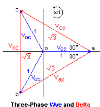

I understand phase voltage (phase to neutral) well, but I'm still confused by what exactly the potential difference is between any 2 phases in 3 phase power. If you were to try to find the potential difference where 2 sine wave phases cross, then at that instantaneous point, the potential difference looks to be 0.
https://en.wikipedia.org/wiki/Mathe...ric_power#/media/File:3_phase_AC_waveform.svg
I think it is easiest to visualize using a vector diagram. Does the following help?
Line-to-neutral voltages are in blue and line-to-line voltages in red. Note that the magnitude of the line-to-line is ##\sqrt{3}## times larger, and ±30 degrees different in phase compared to line-to-neutral.

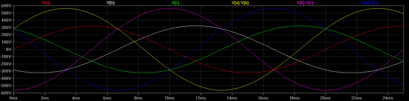

Single phase, 230 Vrms, is now the international standard domestic voltage.
The peak single phase voltage is 230 * √2 = 325 Vpk.
See the plot of the 'Y', single phase voltagess a, b, and c, relative to the neutral.
The Δ difference voltages between phases are also shown. V(a)-V(b), V(b)-V(c), V(c)-V(a).
The difference voltages are 400 Vrms. The peak difference voltage is 400 * √2 = 563 Vpk.
The three phase voltage is root 3 times the single phase voltage.
230 Vrms * √3 = 400 Vrms.
325 Vpk * √3 = 563 Vpk.
