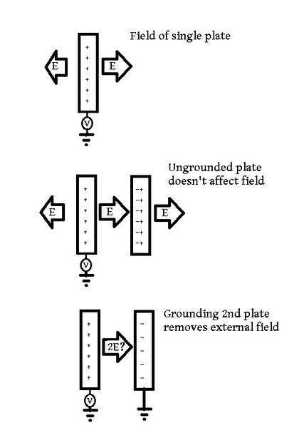

I need pictures.
Thinking about electric fields,
Gauss says total flux leaving each plate equals total charge on it.
Do you know how to calculate the field surrounding a plate ? Infinite sheet would be the extreme case...
Assuming they're thin, as @mfb stipulated,
"Grounding" 2nd plate changes its potential by E X Distance between plates?
I never worked that problem
but that's how i would approach it.
@mfb - did i miss something fundamental ?
old jim

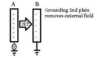

Can I point out a mistake here? In the second diagram, we have two plates: plate A with positive charge say +Q (or alternatively we can say the plate is having surface charge density of +σ) and other plate B is uncharged. Now the +Q charge with spread evenly on the left (outer) and right (inner) faces of plate A with +Q/2 charge on each face. The charge on inner side of A will induce -Q/2 charge on inner side of B and +Q/2 charge on outer side of B.
Now, E at the leftmost region will be
= σ/2ε° directed outwards from the plate A.
E in the middle region of plates= 2 times σ/2ε° from A to B.
E in the rightmost region will be = σ/2ε° i.e. directed outwards from the plate B.
That is, E/2 along -ve x-axis , E along +ve x-axis and E/2 along +ve x-axis respectively.
Where E has value E= σ/ε°.
So, values of electric field in the outer regions are E/2 if we take E equal to σ/ε°.

That's true in the third image but not in the second.
Gauss tells us the total flux leaving(or entering) a surface equals the charge enclosed.
Because in middle image the plate B still has zero net charge, all the flux that enters B from left exits B toward right as if B weren't there.
B with no net charge does not affect the field from A (except as noted by @mfb due to its finiteness).
The field strength is same everywhere for middle image.
That's why we ground a shield because an ungrounded one is electrically not there.
Bottom image differs from middle in that plate B has acquired net charge.
So its field reinforces that from A between the plates and cancels it outside them. That's why a charged capacitor doesn't make much of an external field.
In between the plates field strength is their sum and outside them it's their difference. You used E/2 and E, i used E and 2E .
O yes, you are right. Mistake was all mine. Pardon. Thanks for clarifying. Actually I wrongly built up a concept that if a face of charged plate has charge Q/2 on it, that means it has a surface charge density σ/2 on that particular face, then electric field due to that face will be σ/2ɛ°. Thus I add up the respective fields in the middle region, giving me wrong value σ/ɛ°.
My mistake was that I assumed when charge Q is given to any isolated metal plate, it redistributes as Q/2 on both the faces of plate. Everything is right up to here, but I inferred that this redistribution means surface charge density σ also redistributes as σ/2 on both the faces. That's so stupid of me, because how did not I realize if Q halves, A also halves while taking one particular face. So σ will be same, whether we take one face or both.
You are right, E in the second image will be same throughout.

Sticking with what's familiar
Plate A has potential to Earth VA = Q/CA where CA is the capacitance of a single plate to Earth . That capacitance is quite small so VA is probably surprisingly high.
Plate B has potential to Earth of VA - (E X D) because it's in A's field.
CA is not straightforward to calculate because it's a plate not a sphere. A disc plate is easier to calculate than a square so let's use that..
Were it a sphere it'd be just CA= 4πε0Radius see http://hyperphysics.phy-astr.gsu.edu/hbase/electric/capsph.html
Here's a derivation of capacitance of a single disc from http://www.hep.princeton.edu/~mcdonald/examples/thindisc.pdf
but it appears to be written in Gaussian units not SI
where b is the disc's thickness and a its radius
which fortunately simplifies to C = about 2 X Radius / π but I'm still wrestling with Si vs Gaussian units . Should be an epsilon in there someplace. https://en.wikipedia.org/wiki/Gaussian_units
Anyhow when we ground the second plate, we have changed from a single plate capacitor to a parallel two-plate capacitor.
That's straightforward, CAB = ε0Area/Separation of the plates (in SI)
Now plate B is at zero potential and since your thought experiment locks charge at Q,
plate A is at potential VAB = Q/CAB
In SI , CAB= ε0 X πRadius2 / Distance between plates
so VAB = Q / ( ε0 X πRadius2 / Distance between plates)
Grounding the second plate then affects voltage V on plate A by ratio of CA to CAB
VA / VAB = CAB / CA because voltage on a capacitor = Q/C
To get their ratio i must get the capacitances both into same units.
If Wikipedia's 'Gaussian Units' page is correct and this is the conversion factor , there's my missing ε..
I must multiply CA by 4πε0 to get it to SI.
CA = 4πε0 X 2 X Radius / π
and
CAB = ε0 X πRadius2 / Distance between plates
Ratio of CAB to CA = π X Radius / (8 X Distance between plates ) please check my arithmetic !
So VA / VAB = π X Radius / (8 X Distance between plates )
The closer the plates the larger the ratio and that agrees with intuition so i trust my arithmetic.
Plate A does work on plate B as it pushes positive charge out of it into earth. Or attracts negative onto it if you prefer.
That work comes from reduced potential on plate A . Some of it shows back up as energy stored in the field between A and B. The rest is lost as heat in the resistance of the conductors.
But there's a much easier way to think about it.
What happens if you separate the plates of a charged capacitor by mechanically pulling them apart ?
The plates attract one another because of their opposite charges.
So you must overcome that attractive force , doing work on them Force X Distance as you pull them apart.
That work shows up as increased voltage across the capacitor.. Increasing separation reduces capacitance and with fixed Q voltage must increase with separation because Q = CV .
Your exercise is almost the reverse - bringing the plates closer together would reduce voltage as capacitance increased. Your work went into moving charges through fields as current through conductors instead of moving charge through fields along with the plates..
I think that would be a far better lead-in to this concept. It's the one my High School electronics teacher used on us boys. You can't teach Maxwell's equations to kids just taking second year algebra .Here's a tutorial i stumbled across while looking for an approach to this 'explanation' , i didn't use it but it might be of help to you locking in your basics. ..
ftp://ftp.bartol.udel.edu/evenson/MonitorDocs/Thailand_Workshops/Workshop%201/Analog%20Reference/Capacitance.pdf
I'm going to hit "Post " now. Preview doesn't show my images so i'll probably have to edit a few times (and fix typos)
If anyone versed in vector calculus and Maxwell sees a basic mistake in my reasoning please point it out. As i said, I've never worked this one before.
old jim

separating the plates of a charged capacitor
mfb said:
What is the potential of a single charged plate with respect to infinity? This is not an easy question,

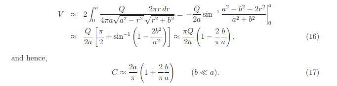

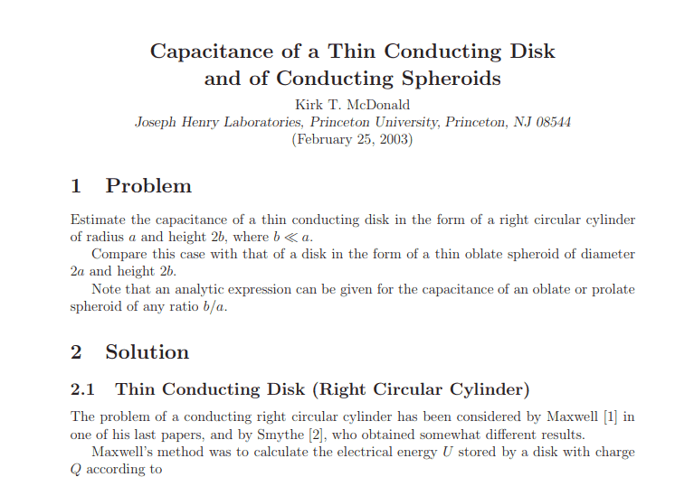

I found this link Capacitance of an infinitely thin disc. which suggests that the Capacitance (to ∞) would be 8ε0R. So the Capacitance of the outer half to ∞ would be half that(?).
Wouldn't that allow you to calculate the potential by using the potential divider formula (Capacitance Version), using the C between the plates and the C to infinity of the parasitic plate?
Hmmm.. one says about 2/3 r (2/pi) and other says 8 r ,,
first is Gaussian
2R/π (Gaussian) X 4πε0 (Gaussian to SI factor) = 8ε0 R
I love it when diverse sources agree !
I'll have to chew on that divider approach. Sounds logical !
old jim

Thank you @jim hardy for the clear explanation, it helped me too as these concepts were not so deeply dug by me.
but the link you provided for calculation capacitance of single plate(alone) http://www.hep.princeton.edu/~mcdonald/examples/thindisc.pdf
seems not working ("preview not available" error occurred) can you please provide more details over that, I shall wait.
dlgoff said:
It downloads the pdf file for me
It opens fine for me too.
I have my browser set to use adobe reader as default for opening .pdf files. Do you have adobe reader installed? It's free but big, and somewhat annoying to use.
