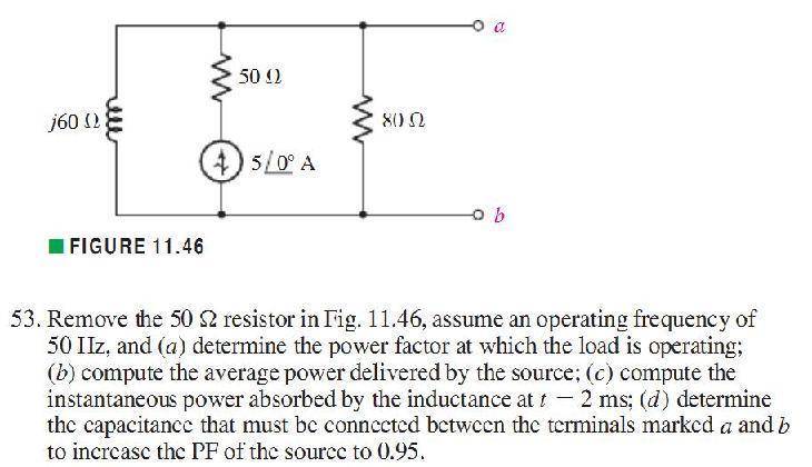

See attachment.

(a)
Ieff = 5 A
f = 50 Hz or [itex]\omega[/itex] [itex]\approx[/itex] 314 rad/s
Zeq = [itex]\frac{80(j60)}{80+j60}[/itex] = 28.8 + j38.4 Ω(48[itex]\angle[/itex]53° Ω)
V = (5[itex]\angle[/itex]0)(48[itex]\angle[/itex]53) = 240[itex]\angle[/itex]53.13010235° V
Pavg = (5)[itex]^{2}[/itex](28.8) = 720 W
PF = [itex]\frac{720}{1200}[/itex] = 0.6
(b)
Pavg = 720 W
(c)
PR(2 ms) = [itex]\frac{57600cos^{2}(314(0.002)+53°)}{80}[/itex] [itex]\approx[/itex] 253 W
-tan([itex]\frac{{\omega}L}{R}[/itex]) [itex]\approx[/itex] -36.85°
P(2 ms) = 1200cos(314(0.002)-36.85°)cos(314(0.002)) [itex]\approx[/itex] 968 W
PL(2 ms) = P(2 ms) - PR(2 ms) = 715 W

I want to know if I am going in the right direction or if I'm doing it all completely wrong haha. I don't want to do part (d) until I know the other parts are headed in the right direction.

The image is not appearing for me. Can you try to post it again?
It should show up now (attached to the first post).
(a) and (b) are correct. I haven't figured out what is being asked in (c). I read it as being asked to express instantaneous power as a function of time, specifically t - 2msec, but you seem to have read it as t = 2msec. Is precisely half of the equals sign missing?
Yeah, it is t = 2 ms. For some reason, it cut off half of it.
