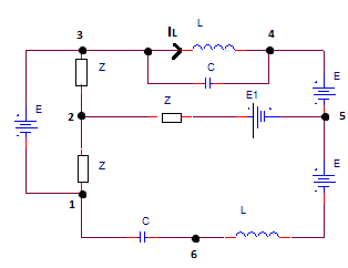

Given the circuit of sinusoidal current (attachment 1) with given data:
[tex]\underline{E}=100V,\underline{E_1}=40V,\underline{Z}=(10+j10)\Omega,\omega=10^5rad/s,L=1mH,<br /> C=0.1uF.[/tex] Find [itex]\underline{I_L},\underline{U_{16}}[/itex], active and reactive power in the branch [itex]2-5[/itex].
2. The attempt at a solution
Using the loop current analysis we can find four loops (attachment 2) that correspond to linear system of four complex equations:
[tex]C_1: (2\underline{Z}+jX_L)\underline{I_{C1}}-\underline{Z}\underline{I_{C2}}-\underline{Z}\underline{I_{C3}}+\underline{Z}\underline{I_{C4}}=\underline{E_1}-\underline{E}[/tex]
[tex]C_2: 2\underline{Z}\underline{I_{C2}}-\underline{Z}\underline{I_{C1}}+\underline{Z}\underline{I_{C3}}+\underline{Z}\underline{I_{C4}}=\underline{E_1}+\underline{E}[/tex]
[tex]C_3: 2\underline{Z}\underline{I_{C3}}-\underline{Z}\underline{I_{C1}}+\underline{Z}\underline{I_{C2}}-\underline{Z}\underline{I_{C4}}=\underline{E}[/tex]
[tex]C_4: (2\underline{Z}-jX_C)\underline{I_{C4}}+2\underline{Z}\underline{I_{C1}}+\underline{Z}\underline{I_{C2}}-\underline{Z}\underline{I_{C3}}=\underline{E_1}-\underline{E}[/tex]

Near the end of all your analysis you have: I52 = IC1+IC2+IC3 but I think it should be I52 = IC1+IC2+IC4

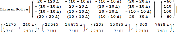

You sure used a cumbersome method of solving the system. Modern symbolic algebra software can solve the system in one go:

You are correct about the current [itex]\underline{I_{52}}[/itex]. It should be [itex]\underline{I_{52}}=\underline{I_{C1}}+\underline{I_{C2}}+\underline{I_{C4}}[/itex].
