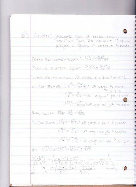

Here's what I gathered from your help. I'm sorry, I still have trouble visualizing these tactics. I understood that when counting (and I gather that order does not matter because we are only using their suit and not their identity or their location in the deck) then we must use combinations. What confuses me most I suppose is the scaling of the sample space as we define the these combinations. It made a little more sense when I did 52C26. That split the suit in half seeking out all combinations of 26 cards where 26 of them were the ones we wanted, I wrote comments justifying what I did, but I'm not the least bit confident in that final answer. It doesn't calculate well and I think I still lost it at the last second when I did Nc.
To me, I had 13 possible cards to choose from (otherwise my approach would not be consistent with what i did for Nc) and then I sought out the possible remaining spades and the possible remaining nonspades from their respective remaining wholes. This is why I used the numbers I did.
Then I just attempted N/D using N * 1/D

I'm afraid I can't read that attachment.
I'm sorry, I will type it in the morning. We went over it in class and I believe it is clearer, but counting is surprisingly difficult to wrap my head around. I'm trying to comprehend my professors idea of seeking first out the tuple and then identify ways to partition it. I think this is where you were headed as well.
