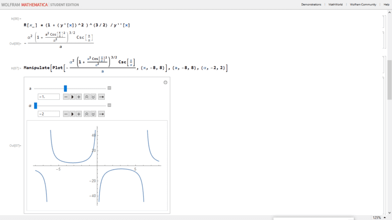

Rmn, turns out to be radius of curvature at that point where Sine function has maximum value. So, the curve is a straight line. And radius of curvature of straight line is infinity, right? So, where am I wrong?

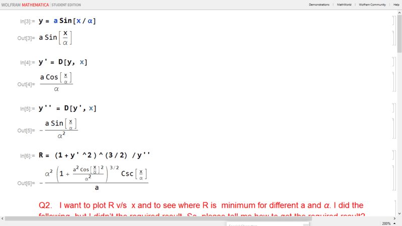

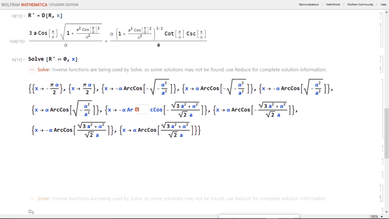

I copied these latex codes from mathematica. Now how to bring it in the standard form?
\documentclass{article}
\usepackage{amsmath, amssymb, graphics, setspace}
\newcommand{\mathsym}[1]{{}}
\newcommand{\unicode}[1]{{}}
\newcounter{mathematicapage}
\begin{document}
\begin{doublespace}
\noindent\(\pmb{\text{}}\)
\end{doublespace}
\begin{doublespace}
\end{doublespace}
\begin{doublespace}
\noindent\(\pmb{\text{}}\\
\pmb{}\\
\pmb{y= a \text{Sin}[x/\alpha ]}\)
\end{doublespace}
\begin{doublespace}
\noindent\(a \text{Sin}\left[\frac{x}{\alpha }\right]\)
\end{doublespace}
\begin{doublespace}
\noindent\(\pmb{y'= D[y,x]}\)
\end{doublespace}
\begin{doublespace}
\noindent\(\frac{a \text{Cos}\left[\frac{x}{\alpha }\right]}{\alpha }\)
\end{doublespace}
\begin{doublespace}
\noindent\(\pmb{y\text{''} = D[y',x ]}\)
\end{doublespace}
\begin{doublespace}
\noindent\(-\frac{a \text{Sin}\left[\frac{x}{\alpha }\right]}{\alpha ^2}\)
\end{doublespace}
\begin{doublespace}
\noindent\(\pmb{R = \{(1+ y' {}^{\wedge}2){}^{\wedge}(3/2 ) \}/y\text{''}}\)
\end{doublespace}
\begin{doublespace}
\noindent\(\left\{-\frac{\alpha ^2 \left(1+\frac{a^2 \text{Cos}\left[\frac{x}{\alpha }\right]^2}{\alpha ^2}\right)^{3/2} \text{Csc}\left[\frac{x}{\alpha }\right]}{a}\right\}\)
\end{doublespace}
\begin{doublespace}
\noindent\(\pmb{\text{DSolve}[R'[x] =0, x]}\)
\end{doublespace}

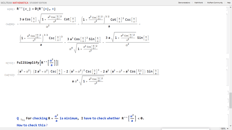

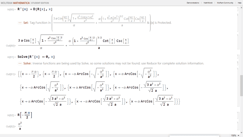

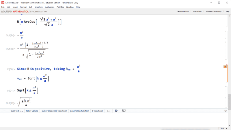

Pushoam said:
So, the maximum allowed speed is ##v_{mx} = \sqrt { k g R_{mn} }##
where Rmn is the minimum radius of curvature
Yes.
If the curve is given in Cartesian coordinates as y(x), then the radius of curvature is (assuming the curve is differentiable up to order 2):
##R = | \frac { \left ( 1 + y' ^2\right )^ \frac 3 2 } { y" }|##
OK

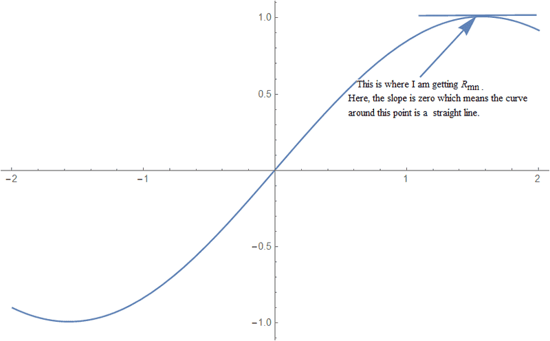

Yes. It's not hard to prove it without a computer. If you inspect the expression for R as a function of x for this specific y(x), you can see that the denominator attains its maximum value at the same point that the numerator attains its minimum value.
I'm not sure what you are saying here. What curve are you referring to?
I am referring to that curve for which I have calculated Rmn.
I have got Rmn at that point for which Sine function has its local maximum. At the point of local maximum the slope is zero. Slope being zero implies that the curve is a straight line.
Why wouldn't a slope of 1 also imply that the curve is a straight line?
Knowing the value of the slope of a curve at some point does not tell you anything about the curvature at that point. Rotating the whole curve rigidly would change the slope values but would not change the curvature values.
What I want to say that even the upper part of a circle has maximum at some point say(x0 , y0 ). And if I use the above formula for calculating the Radius of curvature , then around (x0 , y0 ), the curve is a straight line with slope zero and a straight line has an infinite radius of curvature. I am having some confusion here.
Approximating a small region of a curve by a straight line is going too far when you are interested in the curvature. Curvature is related to approximating a small region of a curve by a "best fitting" circular arc. The radius of curvature is then the radius of this arc. The slope involves only the first derivative of the function. But curvature requires knowledge of the second derivative (that is, how the slope is changing as you move along the curve).
Note that at a point where ##y'(x) = 0##, ##R = \frac 1 {|y''(x)|}##.
Yes, the slope is zero, but that is just y'. Your straight line there is just the tangent. Putting y'=0 in your formula does not give infinity. You need to calculate y" and plug that in too. (If that were zero then it would be a straight line.)
