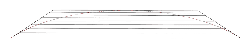

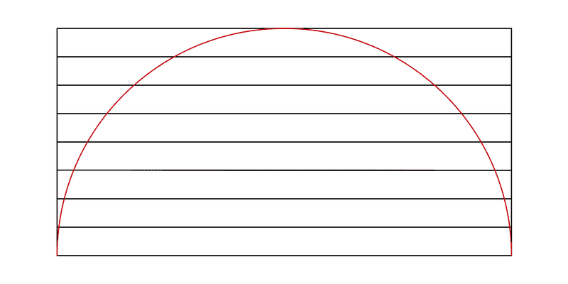

Your post helped me a lot. I got me thinking quite a bit. I couldn’t shake the idea that there must be some foreshortening, yet I couldn’t see how one would see an ellipse. For a while, I thought you were right. I thought that my paper might be taking the long way around to describing a circular arc. Eventually, I realized that we were both wrong.
The thing is, we don’t see the world the way we describe it with geometry. For example, we see straight lines as curves. If you doubt this, imagine standing beside a tall fence which stretches far to either side. When you look at the part of the fence nearest to you, you see the top of the fence with a horizontal slope. But in your peripheral vision to the sides, you see the slope gradually changing downward. Clearly, you must be viewing the straight line as a curve. Our minds tell us that the edges of buildings are straight, but they actually appear as curves. For more on this, look up Helmholtz’s chessboard.
One of the attached images shows the plan view of a playing field which is marked with a semicircular arc and equally sized rectangles. The other image is a perspective view which would be seen by someone standing at the focus of the circular arc (and thus their eyes would be at the apex of a cone). You can see that in the perspective view, the rectangles gradually get more foreshortened the further you look down the field. And of course, the circular arc is being foreshortened in a similar manner. Since the foreshortening is variable, the resulting curve will be neither circular nor elliptical.
This does not affect my paper. My algorithm does not depend on the shape being an ellipse – that was just my intuition. My algorithm selects points on the horizon circle, calculates their Cartesian coordinates, and then, through a series of coordinate system transformations, shows where the point would appear in a spherical coordinate system with the observer at the origin. Thus, point by point, it constructs the curve that the observer would see.
That is an irrelevant coordinate transformation from planar to spherical. It does not alter the fact, that in spherical visual coordinates, the observed equator will always be a circle. By moving the line of sight, away from the original observer's position, the circle then becomes foreshortened, into an ellipse, when seen from the original observer's position. If we are in different positions, my horizon will look like an ellipse to you. For me, my horizon will always be a circle on my visual sphere.
Because your eyes see things positioned on your visual sphere, your horizon will remain a circle, no matter which point you centre your vision on. The image plane will remain spherical, the horizon will remain a circle.

ScarBest said:
Why should circular arcs necessarily appear circular when straight lines appear curved?
Because the equator is special. It is everywhere at the same distance from the observer, no matter what our line of sight. It is always mapped as a circle onto our visual sphere.
ScarBest said:
To test this, I introduced a straight line into my model. I transformed several points along the line, and from the point of view of the observer, my calculations produced exactly the sort of curve that you would expect the observer to see.
How do you know what I would expect the observer to see?
You have not shown the equations, nor the code you use, so we have no way of checking if it is applicable to projection of the equator onto the visual sphere of the observer.
As an aside, there is a special shape-preserving projection from a sphere to a flat plane. I have used the Wulff Net for analysis in structural geology.
https://en.wikipedia.org/wiki/Stereographic_projection#Planetary_science

ScarBest said:
If you one stands at the focus of a large horizontally-oriented semicircle, ...
Is the observer above a focus of the circle, or above the centre of the circle?
The focal length of a circular arc, is half the radius.
https://en.wikipedia.org/wiki/Focal_length#General_optical_systems
ScarBest said:
A circular arc can not do this.
I disagree. If you draw a circle on a vertical wall, with its centre at the height of your eyes, the top and bottom arcs are closer to horizontal, while the side arcs of the circle are closer to vertical. But you always view your horizon circle from a point above the centre, and your horizon circle lies entirely on one horizontal plane, being defined by the tangent of the cone with its apex at your eye, and the spherical Earth. You cannot map that horizon plane onto another plane, because your eye must always remain at the apex of the tangent cone.
The image of the horizon circle falls on the retina of your eye, which is a spherical surface. No matter where it falls on the retina, it will remain a circle in spherical coordinates.
There are a couple of astronomical analogies.
The full Moon looks round, even when it is away from the centre of your vision.
When you look at a constellation of stars, the pattern can be specified by the angular separation between pairs of stars. The pattern looks the same, no matter where it falls in your vision, or how it is rotated.
There is no foreshortening of the Moon, or of a constellation, nor of the circle of your horizon.
There is no requirement that you look along the axis of the tangent cone. You can kid yourself that your horizon circle could become an ellipse, but you would need to cheat, by removing your eye from the apex of the tangent cone to do that. If you move your eye from the apex of the tangent cone, the original line ceases to be your horizon.
I'm not talking about a lens, I'm talking about a circle, for which the focus is at the center. The observer is at a short distance above the plane of the circle, directly above the center.
Yes, of course, if you draw the circle on a vertical wall. This is the ONLY case in which a circle will fit. But if the semicircle is on a horizontal surface, and you view it from a short distance above the center, the curve you see will be 180 degrees from side to side, and less than 90 degrees from bottom to the curve, with the slope of the curve horizontal in front of you and vertical to the sides. A curve which APPEARS circular can not do this.
Not if the shape of the curve entering your eye is not circular, due to foreshortening.
Well, it seems to, but then, straight lines seem straight, even though they're curved.
Exactly. Constellations are purely angular. They don't occur on a plane.
The moon is so far away that the angle of your line of sight to the plane of the horizon circle is almost perpendicular when you're looking at the limb (which is the horizon). Any foreshortening is negligible. It makes no sense to talk of foreshortening of the constellations.
As I said, I was wrong about it being an ellipse. It is a distorted image which is neither a circular nor an elliptical arc, due to variable foreshortening, which is due to the degree of foreshortening being a function of the angle that the line of sight makes to the plane of the ground. One does not need to move from the apex of the cone for this.
