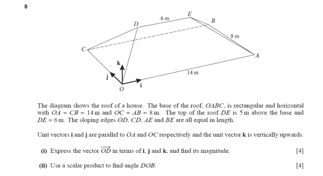

I'm confused ,here's ... my attempt..
all I know so far is the
the k component would be 5...
I have no idea what to do with the i and j

drop perpendiculars DP and EQ onto the base …
where are P and Q in relation to ABCD ? :wink:​
Hint: Assume DE is located such that its midpoint is positioned directly over the intersection of the base diagonals OB and AC.
Hmm is DE is assumed to be at the mid point then.. for the j component that would be 4j
but the i? ... umm is it like the base below DE is 8 because DE is 6cm and OA is 14? so 14-6?
when I dropped the perpendiculars they ended up being at the midpoints of the widths of the base
You had your answer in this post, but didn't realize it. 14 - 6 = 8, and this difference is split evenly between between the two sides. So the i component is 4.
(we'll call them P and Q)
ok … so the next line in your proof would be to say what the distance PQ is
and then you can compare that with the length of the base :wink:
