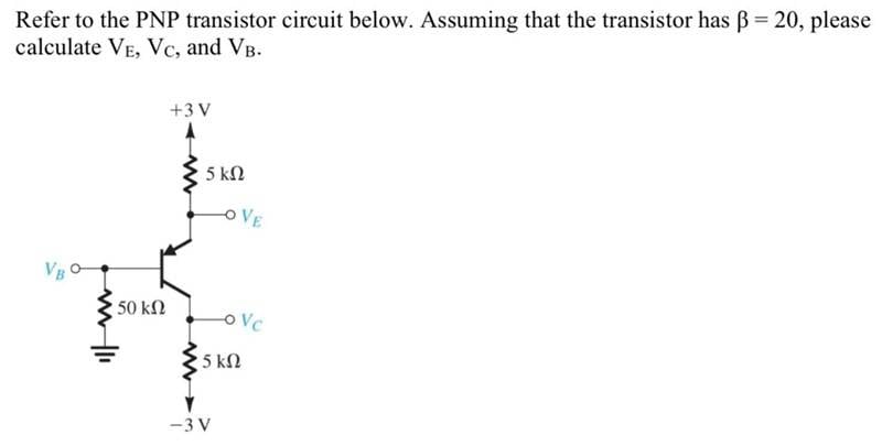

Hi,
I have a textbook problem that I've tried to solve, without any success. You see the question and my attempt below.
How to calculate VB, VE, and VC
The problem:
