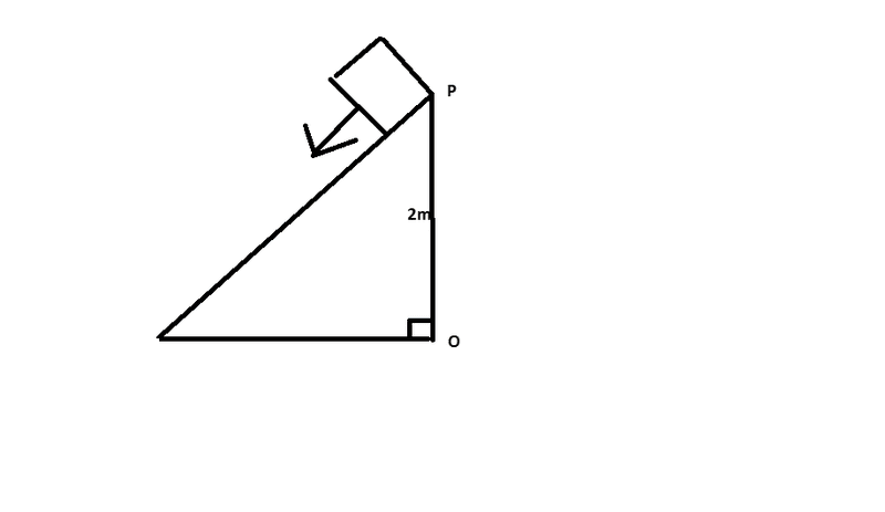

A 0.5 Kg block slides from rest down an inclined plane as shown in the figure. The velocity at the bottom of the plane is 6 m/s. The vertical distance PO is 2m.
(gravity = 10m/s2
If the block were to be dropped from P, what would be the velocity at O?
As shown in which figure?:wink:
Looks like O is directly below P. Is the whole inclined plane scenario simply an obfuscation?
I am not sure if it is an obfuscation, it is from a question from a past practice examination I'm doing... I just am not sure how to calculate the speed of the block if it was dropped from O to P, like I'm pretty sure they mean if it just fell without anything underneath it. They gave the speed of it sliding down the block so I could calculate the kinetic energy at the bottom which was the first part of the question.
As given, the problem did not mention if friction acted on the plane, or the angle of the plane. So you have no way to relate the velocity of the sliding block at the bottom of the plane to a block that simply drops vertically without friction. Seems to me that you can only assume that they want the velocity of an object that free-falls vertically from 2 m.

Hi this would be V2=V02+2as
So I would get : V2= (0)2+2(10)(2)
V2= 40
V = √40
V=6.32 m/s

Yes.
Are there more parts to the question? Maybe one part is to find the coefficient of friction.
I do not believe there is friction. I think the point of the problem is to compare slide down on a frictionless incline with a straight drop in the absence of air resistance.

Unfortunately no, the only other part of the question says the same thing happens where the block is dropped from P to O except on the moon which has a (g) of 2m/s2 and explain whether the velocity at O would be greater or lesser than the value obtained for on earth, which of course it would be lesser because the smaller the acceleration according to the formula V2= V02+2as reducing acceleration will clearly reduce it's final velocity.
