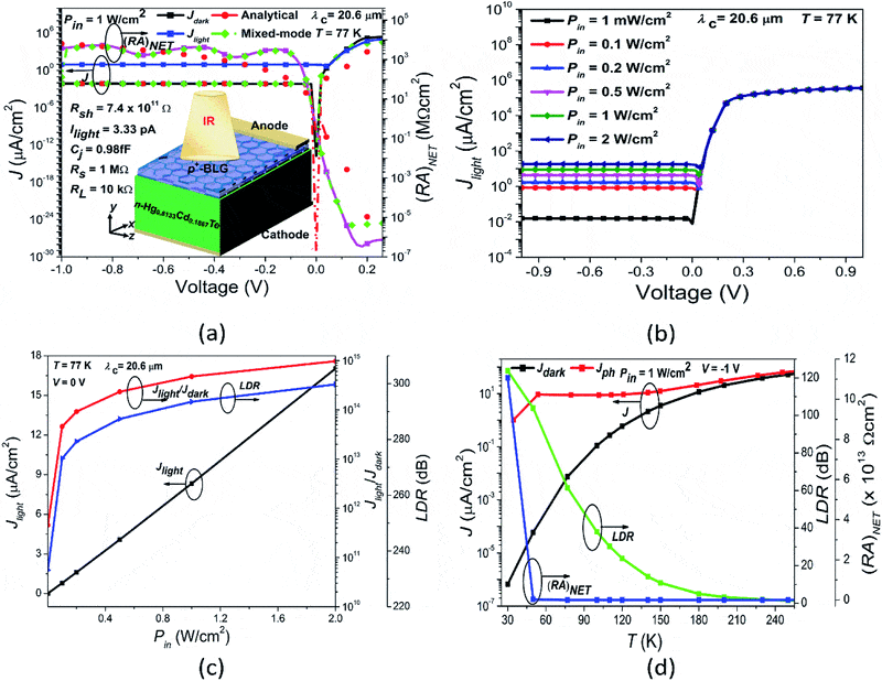

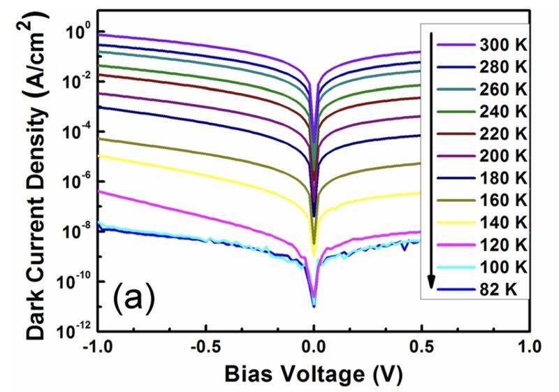

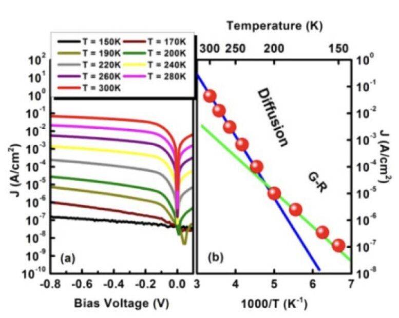

Why does Figure 2 show 1mA/cm^2 of DC dark current with 0v bias voltage at 161k? It shows the dark current in amps being directly proportional to the surface area of the imaging sensor & non-zero with 0v bias & no photocurrent. For a sensor 31.7cm x 31.7cm that’s more than a full amp of DC current.
If I have a 0v bias voltage, 161k photovoltaic IR sensor in a 161k telescope with the lens cap on, I shouldn’t be able to generate any useful DC current because the Carnot efficiency is 0%…
https://www.researchgate.net/publication/345174470/figure/fig2/AS:1022731785080842@1620849667815/Dark-current-density-versus-applied-bias-measured-at-several-temperatures-for-the-T2SL.png
Fig. 2: “Dark current density versus applied bias measured at several temperatures for the T2SL MWIR 15 Â 15 detector array of 15 μm pitch and a 4.6 μm cut-off wavelength.
https://www.researchgate.net/figure/Dark-current-density-versus-applied-bias-measured-at-several-temperatures-for-the-T2SL_fig2_345174470

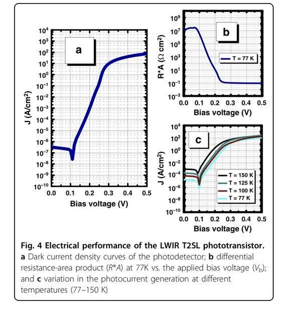

https://www.researchgate.net/publication/345174470_1f_Noise_and_Dark_Current_Correlation_in_Midwave_InAsGaSb_Type-II_Superlattice_IR_Detectors/fulltext/609c2ee8299bf1259ecd763c/1-f-Noise-and-Dark-Current-Correlation-in-Midwave-InAs-GaSb-Type-II-Superlattice-IR-Detectors.pdf?origin=publication_detail
  • #54

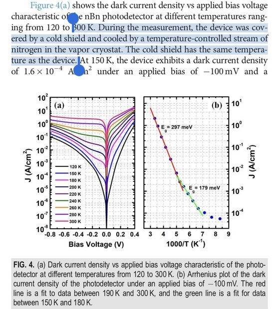

Also this paper Fig 4 shows about 0.4 amps dark current at 300k in a 300k enclosure for a 31.6cmx31.6cm sized detector…
“Figure 4(a) shows the dark current density vs applied bias voltage characteristic of the nBn photodetector at different temperatures ranging from 120 to 300 K. During the measurement, the device was covered by a cold shield and cooled by a temperature-controlled stream of nitrogen in the vapor cryostat. The cold shield has the same tempera- ture as the device.
https://www.researchgate.net/profile/Arash-Dehzangi/publication/335005180_Demonstration_of_mid-wavelength_infrared_nBn_photodetectors_based_on_type-II_InAsInAs_1-x_Sb_x_superlattice_grown_by_metal-organic_chemical_vapor_deposition/links/5d4a53afa6fdcc370a80ec0c/Demonstration-of-mid-wavelength-infrared-nBn-photodetectors-based-on-type-II-InAs-InAs-1-x-Sb-x-superlattice-grown-by-metal-organic-chemical-vapor-deposition.pdf?origin=publication_detail
  • #55
Devin-M said:
Why can’t they avoid the need for cooling the telescope to cryogenic temperatures by operating the detectors with zero bias voltage (photovoltaic mode)? As long as the telescope is the same temperature as the sensor, say 300k telescope and 300k sensor, how can there be any noise-generating dark current?
"the telescope" is a mirror. The camera isn't trying to avoid detecting the mirror it is trying to avoid detecting itself. If it isn't cooled, the whole apparatus is trying to image a background that's colder than it is.
The issue you raise and are hyper-focused on feels a lot like a typical perpetual motion machine problem: people "invent" PMMs that are just complicated enough that they don't understand them well enough to be able find the flaw and instead assume they work.
I don't understand the quantum mechanics of how my cameras work, but I do know that without cooling they operate above ambient temperature, meaning they are net emitters of heat, not absorbers, much less 2nd law violators/spontaneous coolers.
  • #56
See Fig 4a in post #54.
I also assume the 2nd Law is inviolable, and I also don’t understand the quantum mechanics (I was hoping someone would explain the quantum part), but the current measurement with 0v bias voltage and everything 300k (sensor & surroundings) was roughly 4*10^-3 amps “dark current” per cm^2 of sensor area which works out to about 0.4 amps with a 31.6cm x 31.6cm sensor size. I was hoping someone would explain the quantum mechanical part because the Carnot efficiency with same temp sensor and surroundings should be 0%.
I’m trying to understand the quantum dynamics, not make a perpetual motion machine or violate the 2nd Law.
  • #57
Measurement error given the circuit configuration?
Keep in mind when the data was measured for the plots, the photodetector was placed in an active circuit. The bias voltage was then adjusted, maybe by adjusting a potentiometer in a voltage divider circuit, or perhaps by adjusting the output voltage of a benchtop power supply -- a power supply attached to the circuit specifically for bias voltage adjustments, where the rest of the circuit was powered by a separate supply. Something like that.
By tweaking the bias voltage in the active circuit, one can sort-of simulate a passive circuit when the bias voltage is at 0 V. But any error in the method, or any minor, non-ideal property of the circuit that still provides power to some parts of the circuit, could manifest itself as non-zero measurement when the bias voltage is supposedly "zero."
But what I can all but guarantee is that they didn't yank out the photodetector and place it in a passive circuit just for the special situation of dark current at 0 bias voltage.
You can assume though that if the sensor was actually placed in a passive circuit, such that the photodetector, other components in the circuit, its enclosure, and everything else in the vicinity is all at the same temperature, the dark current density would measure 0.

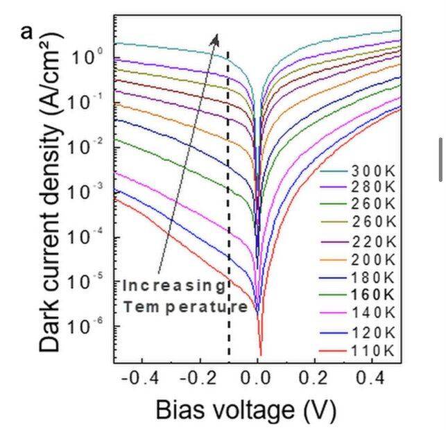

  • #58
I'm not sure this is supported by the graph, it may be, but if the data was collected on a single device (or multiple identical devices) then one cannot see the shape of the curve for the dark current vs active area. Dividing the measured current by the device area all by itself and using this as the Y axis scale does not provide good insight to the area vs dark current shape. Having multiple curves, as we see with the changing temperature does provide this (for temp, and would, for area, if available). Labelling the Y axis this way does imply a linear relationship, and if I were involved in a review of this particular graph, I'd poke at that. As you say, it gives pretty suprising results when one scales it a bit.
I agree with @collinsmark . In my experience reviewing and interpreting semi-conductor measurement data, when one sees a result that looks to be in conflict with physics, one starts from an assumption of measurement non-ideality and tries to identify where its coming from, then one assesses whether it matters enough to go and spend time and $ to attempt an improved measurement. At some point, improved measurements are judged to no longer be value-added, and one calls it a day.
Edit:
Considering the graph a bit more, I speculate that the author was wanting to communicate current density specifically as the quantity of interest in the device being measured, and not intending to imply that it scales linearly with area, and this why the Y axis is reported as it is.

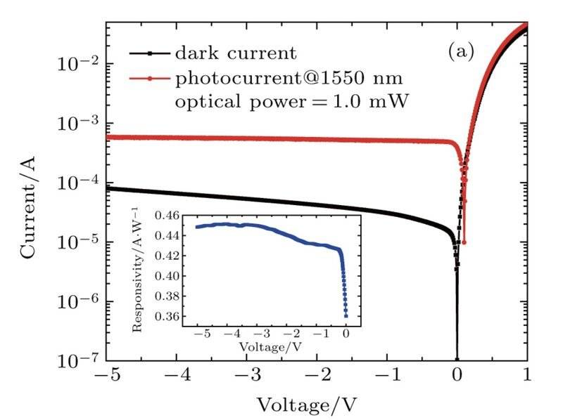

  • #60
More dark current per cm^2 at 0v applied bias voltage at 300k is indicated in this graph than at 120k, -1.0v bias voltage…
https://www.researchgate.net/profile/Junqi-Liu-3/publication/267340100_Room_temperature_quantum_cascade_detector_operating_at_43_m/links/579709df08aec89db7b86bd8/Room-temperature-quantum-cascade-detector-operating-at-43-m.pdf?origin=publication_detail
