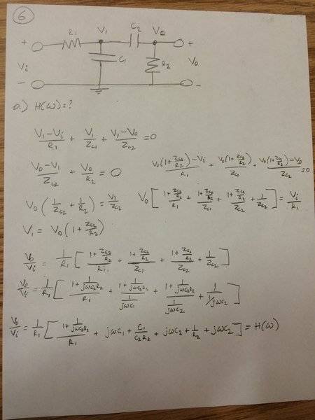

For the circuit shown below:
(a) Obtain an expression for H(ω) = Vo/Vi in standard form.
(b) Generate spectral plots for the magnitude and phase of H(ω), given that R1 = 1 Ω, R2 = 2 Ω, C1 = 1 μF, and C2 = 2 μF.
(c) Determine the cutoff frequency ωc and the slope of the magnitude (in dB) when ω/ωc ≪1 and when ω/ωc ≫1.
Hello, I am working on this problem part (a). I believe what they mean by ''standard form'' is that I need it to include (ω/ω_c), where ω_c is the corner frequency. This expression is so ugly that I don't know how I will ever find an expression for the corner frequency. Is there a way in general to approach finding the corner frequency?
  • Circuit schematic with input Vi across capacitor C1 and series resistor R1, capacitor C2 in series, shunt resistor R2 to ground, and output Vo across R2.

This is a bandpass transfer function with two corners so I don't know what they mean by "the cutoff frequency ". There is no one cutoff frequency ωc.
But you can do the Bode plots OK. I have the two corner frequencies & mid-band gain if you want to compare results.
I haven't done the bode plots because I don't know if my part (a) is correct
Your units are not correct, therefore I know your answer is not correct.
The transfer function should be unit less. Yours is not.
your first two equations look correct.
Go through your work and check the units. You should be able to find your mistake.
Hint: get everything over one common denominator. your units are 1/(Ω^2). you want your units to be Ω/Ω
