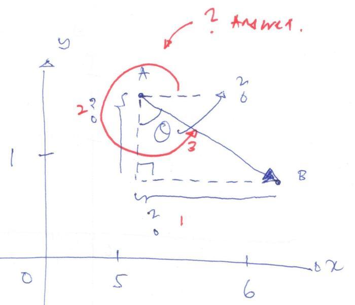

A meteor streaking through the night sky is located with radar. At point A its coordinates are (5.20km, 1.20km), and 1.18 s later its has moved to point B with coordinates (6.24, 0.915).
1. Find the magnitude of its average velocity between these two points.
2. Find the direction of its average velocity between these two points. ( degree is counterwise from +x axis.)

First of all thank you Redbelly98, Leong, and Sheneron for all your help. It's very much appreciated. I got the right answer which came out to be 0.914 =D
now on to the 2nd part:
2. Find the direction of its average velocity between these two points. ( degree is counterwise from +x axis. )
what i did was take the inverse tangent of -0.242/0.881 = 12.41
I also tried -12.41 degree and it was also wrong
I would try sketching a figure and locate the two given points on the figure. Draw the right triangle that is appropriate for figuring out the angle.
find the inverse tangent is right.
the two values are wrong and irrelevant.
I sketched a right triangle, and I for the height i added up the y-components and for the x i added up all the x-components. the hypot i put the magnitude.
So to find the angle, does it mean i can use either cos, sin, and tangent?

figure attached.
I did inverse tangent of sum of y's over the sum of x's. Thus: tangent-1 (2.125/11.24) = 10.70 .. am i doing this right?
I'm sorry I'm new here. How do i approve your pending graph?
you can't. only the moderators can.
i think u will just have to wait.
no it is wrong too.
It's a mistake to take the sums here. Look at your figure again ... the side along x is no where close to 11 units long. Think more carefully about how to calculate that side length. Then do the same for the y-direction side.
