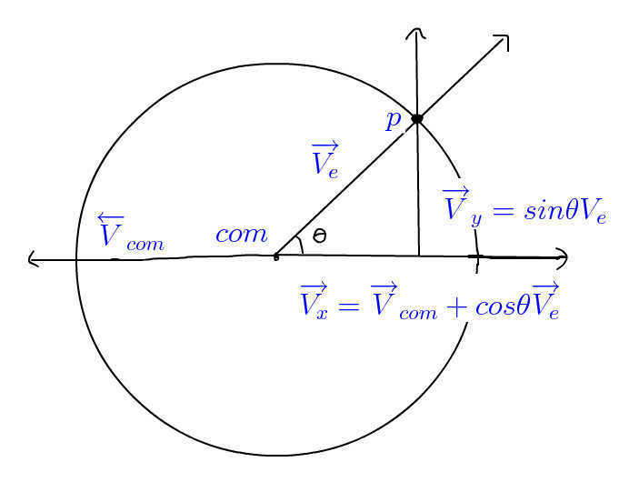

No, I don't believe so. Energy is a scalar quantity, so the expansion velocities will not conveniently cancel out. The only way that I am able to come to any sort of meaningful conclusion regarding the kinetic energy of the sphere is by considering the kinetic energy of the sphere at the very instant that the sphere begins to expand. Here is a picture to help you visualize the situation.

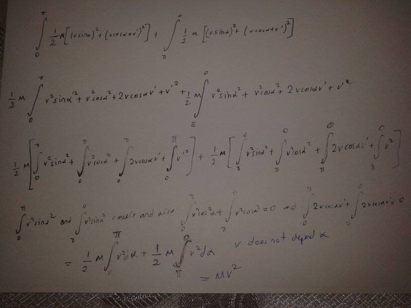

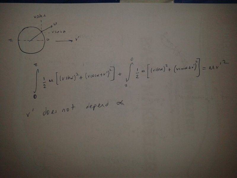

Look the prove of speed.
Yes, that correctly shows the expansion cancels out when computing average velocity. But average KE is not given by squaring average velocity. You have to find the KE of each element separately and then integrate.
There's an analogous result in statistics: the variance is the mean square minus the square of the mean.

I didnt understand this and here what I found
The integrals on the left are ok, but they don't give the answer on the right. please post your steps.
Here the steps
Quarlep said:
Here the steps
The integrals of sin2 and cos2 cannot cancel to zero. The integrands are non-negative everywhere.
You'll find it simpler if you collapse v2sin2 + v2 cos2 to v2.
they can cancel to zero.If we integrate (sinx)2 between 0 and π we get π/2 then we integrate same thing again between π and 0 we get -π/2 there's nothing wrong look carefully.Only my first equation can be wrong.But you said that's true so we get mv2
There's your problem, you're running the integral backwards, getting a negative result from an integrand that's never negative.

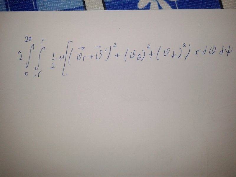

Yeah its a spherical shell.All equations should change now.Can somebody telll me the full equation please ( You need to write it) As I mentioned its not a circle its a sphere.I am 18 I learned Integrals 1 week ago.I don't how to do it myself Just please can somebody calculate it for me.Its very important please.
Here what I found.Is that works ?
I wasn't sure whether you just needed a way to get an answer or wanted to see how it could all be done with integrals. Integrals can be avoided, pretty much. Just use the symmetry. Consider two diametrically opposite mass elements and add up their KEs.

Its my project homeworks one part.So I need equations. Symmetry Idea is very good.I am thinking.You didnt mention anything about my eq but can it be true
I'm afraid I could not make any sense of your latest equations. There seem to some parentheses and plus signs missing, I couldn't understand the bit about "points for which... are constant", or how you would be integrating wrt r instead of wrt theta and phi.

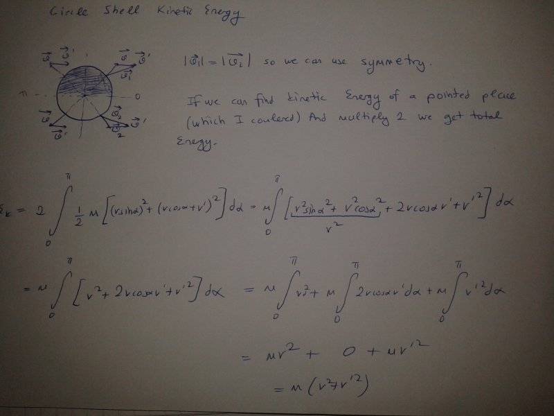

I ll explain it in a moment but now I made a circle shell energy formula.
