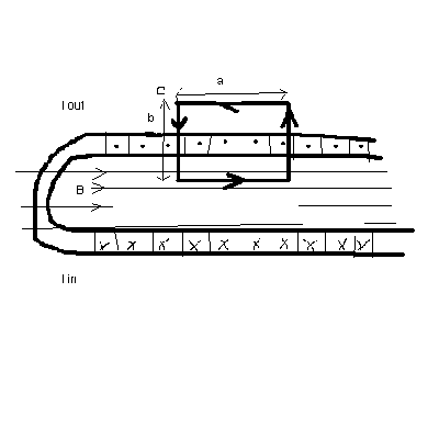

2) A solenoid carries “n” turns per unit length. Apply Ampere’s law to the rectangular curve shown to derive an expression for B assuming that it is uniform inside the solenoid and zero outside it.
I have no idea how to do this. I know that Ampere's Law is \oint B*dl = \mu*I, and the answer should be B = \frac{1}{2}\mu n I ( \frac{b}{\sqrt{b^2 + R^2}} + \frac{a}{\sqrt{a^2 + R^2}}). I don't even understand the diagram. Can somebody get me started on this?
thx for any help in advance.
