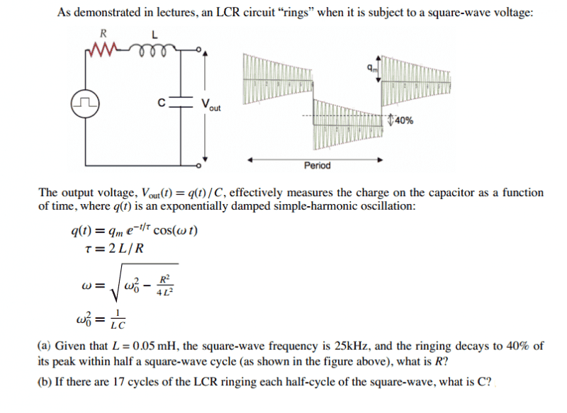

For part (a) i did the following;
the time for it to decay to 40% is half the period of the square wave = 0.00002 seconds
So, 0.4qm = qm ## e^(\frac{-0.00002R}{2L})cos(25000*2*\pi*0.00002) ##
But the cosine term yields -1 which then makes the equation unsolvable, what am i doing wrong?
For part (b) I am a bit confused about the "17 ringing cylcles per half-cycle" but i tried ;
the time for one half oscillation of the square wave voltage is 0.5/(25E3) = 0.00002 seconds
during this time the LCR circuit rings 17 times so the period of oscillation of the LCR circuit is 0.00002/17 = 0.000001176
this corresponds to an angular freq of w = 5340707.511 rad.s^-1
Is this correct so far? and if so, does this mean there will be a different restance in part (b) than in part (a)?
Don't involve the cosine. For the decay all we are concerned with is the exponential envelope.
Thank you, I should have realized that.
Do you know if what i did for part (b) is correct?
Your ##\mathrm{\omega}## looks right. You cannot estimate R from ##\textrm{ω}## because you don't know ##\mathbf{ω}## to the great precision necessary. The exponential decay is what allows you to determine R.
