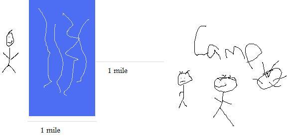

You are standing at the edge of a slow-moving river which is one mile wide and wish to return to your campground on the opposite side of the river. you can swim at 2mph and walk at 3mph. You must first swim across the river to any point on the opposite bank. From there walk to the campground, which is one mile from the point directly across the river from where yous tart your swim. What route will take the least amount of time?

I'm sorry but i feel completely lost. Why are u using pathagoras? if your campground is a straight line from which you started... and i know where to find extrema just can't figure out the algebra behind this problem...

I'm not sure if we have the same picture of the problem (mine is probably wrong)
well look at my attachment that's what i see...
You seem to be under the impression that the camp ground is one mile along the line, extended, directly across the river. If that were the case, the only reasonable thing to do would be to swim all the way across the river and then walk the rest of the way! Are you sure you gave the exact statement of the problem? Does it not say that the campground is on the river one mile from the point directly across?
can someone draw how the picture is suppose to be?... or at least explain it better than the problem did

so could you directly swim from point a to point c? thus using pathagoras' theorem which would be the fastest way... please can someone confirm this.. this problem was driving me nuts

That would be the shortest way- but you can walk faster than you can swim so it is not necessarily the fastest way.
In your picture, mark a point between the perpendicular across the river and the camp and call the distance from the perpendicular to that point "x". Suppose you swim directly to that point and then walk to camp. How far would you swim (as a function of x)? How much time would that require? How far would you walk (as a function of x)? How much time would that require? Add those times to find the total time required, again as a function of x. What value of x makes that minimum?
