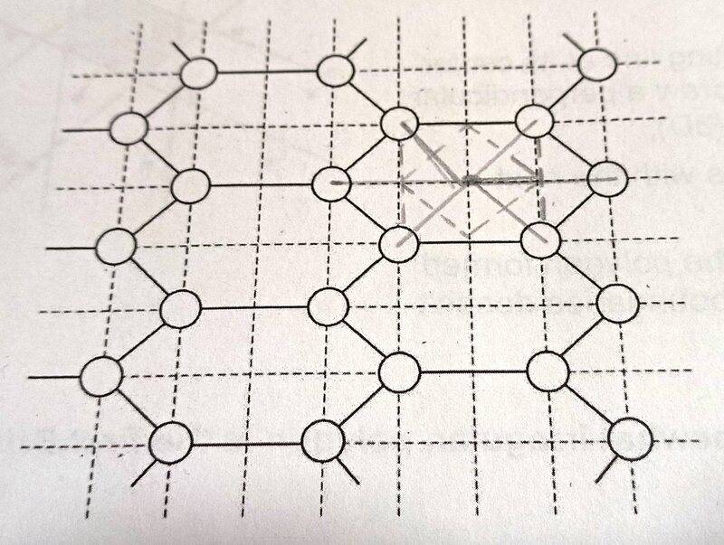

What would be the Wigner-Seitz cell of this lattice?
The Wigner-Seitz (WS) cell is defined as the smallest unit cell containing a single lattice point, which can result in an irregular shape when tracing bisectors. In this discussion, the dotted square is identified as a primitive unit cell, while the hexagon represents a non-primitive unit cell composed of multiple primitive unit cells. The process of determining the WS cell involves identifying the bisectors of the lattice points, leading to the correct representation of the cell's geometry.

Given the lattice shown in attempt to a solution, consider white circles are atoms (of the same type). What would be the Wigner-Seitz cell of this lattice?
Not actually
I know WS cell only contains one lattice point, so we would have to trace bisectors, and obtain some kind of irregular shape.
Anyways, I wanted to check if what I did is okay. It is considering a fictitious point as the center of the (non-primitive) unit cell, which would be one of those hexagons. I don't know if the dotted square would be a WS, or if I should obtain an irregular shape.
Yes, what you have done is okay. The dotted square would be considered a primitive unit cell, while the hexagon would be a non-primitive unit cell. The non-primitive unit cell is made up of multiple primitive unit cells. The irregular shape you obtain when tracing bisectors is a Wigner Seitz cell and it is the smallest unit cell that contains only one lattice point.
