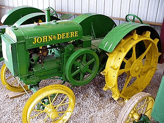

I don't think modern cars have big flywheels like the one below any more
245083
Wikipedia: A 1920s John Deere tractor with the spoked flywheel on the engine. The large moment of inertia of the flywheel smooths the operation of the tractor
The pictured tractor appears to be a model D. That model used a two cylinder engine presumably running on the standard four stroke cycle. I would expect a side-by-side vertical arrangement. (Google didn't say). One piston would be on the exhaust stroke while the other was on the compression stroke. You would want flywheel energy to drive that.
Those old tractor engines could really lug down to low speeds - putt... putt... putt... putt.
Edit: @as clarified by @hmmm27, it is horizontal side by side, 180 degrees out of synch. So you would have power/compression, exhaust/power, intake/exhaust, compression/intake and repeat for a more syncopated putt putt.
