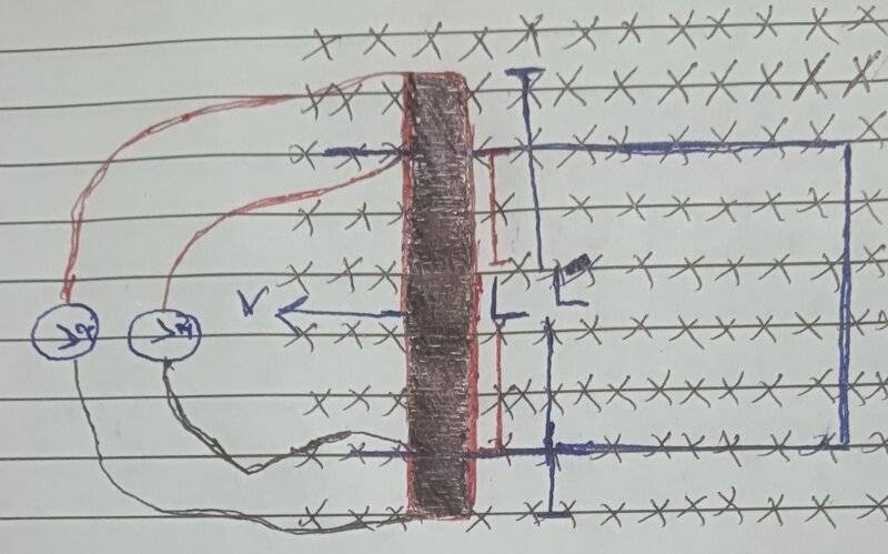

What would the voltmeters measure?

The tale goes like this: A rod moving with a constant speed towards the left on a U-shaped conductor in a uniform magnetic field B that is directed into the page. The width of the U-shaped conductor is L and the length of the rod is L'. V1 is connected across the part of the rod making contact with U-shaped conductor thus completing the circuit, whereas V2 is connected across the whole rod. The voltmeters are assumed co-planar with the rod as far as we're concerned and are held in a plane perpendicular to it.
ε=∮(v̅×B̅)•dl̅=-dΦ/dt
I am saying that V1=V2 since the emf induced in the rod is the same for both cases equal BLv. Am I correct?

Why not?
is not correct
BvU said:
is not correct
Yep, Why isn't it correct?
BvU said:
Are you familiar with the Lorentz force ?
Ofcourse
You forgot to mention the rod is conducting...
And that its resistance is zero ...
And the U-shaped loop also has resistance zero ...
(composing meaningful exercises isn't as simple as it seems :smile:)
So what does ##V_1## read ? Zero or BLv ?
##V_2## reads 2 B(L'-L)v more
