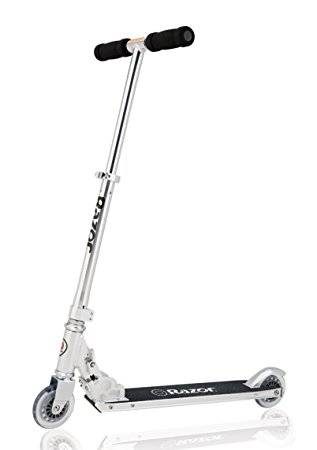

Razor A4:
https://images-na.ssl-images-amazon.com/images/I/51oFjv1DcpL._SY450_.jpg

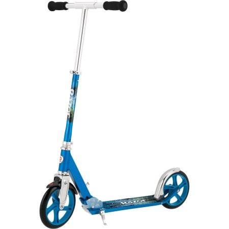

Razor A5
https://i5.walmartimages.com/asr/26....jpeg?odnHeight=450&odnWidth=450&odnBg=FFFFFF

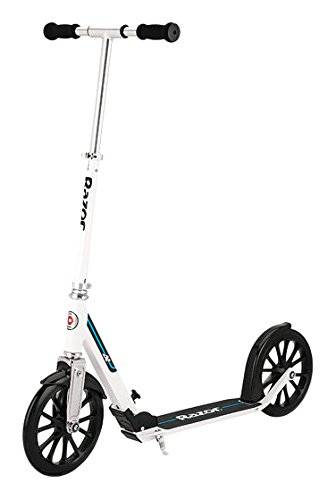

Razor A6:
https://images-na.ssl-images-amazon.com/images/I/41+spWIHPbL.jpg

Another question is they say the A6 was designed for "taller riders", can someone explain what was designed on the scooter for taller riders?
Larger wheels adds more stability, and longer handlebars for more comfortable posture... I'm 6'1" and riding shorter, smaller wheeled scooters gets uncomfortable really quick.

The weights of the A4 and A6 are 3.4 kg and 5.0 kg. When you compare it to your own weight however, that difference isn't significant. The difference in wheel weight is even less significant. For riding experience I would pretty much always take the A6. I think the smaller wheels of the A4 would be very uncomfortable on sidewalks or bicycle paths with tiles, or streets with bricks which are common in the Netherlands. The only reason to choose the A4 would be the price or if you have to fold it up and take it with you inside.

Are the tires of the a6 harder than the a5 ? Cause the a5 didn't slide
No, I had the a5 lux, it didn't seem to lose traction like the a6 does.Not quite sure that this was answered, but which scooter is easiest to push back n forth from school? It'd be the a4 right? Since its the lightest? Can someone elaborate as to which scooter they think would be best?

Is the weight on each wheel balanced?What'd cause the A6, with bigger wheels, to lose traction -- unlike the A5 lux.
I notice that the diagonal piece is much longer on the A6, not sure what that'd affect. Also, the axels are much higher, not sure if that gives a higher center of gravity, or puts more torque on the wheel when going diagonally.
