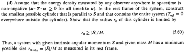

Has anyone solved the part (d) of 5.6 problem of that book?
I am unable to solve it.
It asks the reader to prove that the radius ##R## of a rotating cylinder (rotating around its symmetry axis) has to be greater or equal than ##\frac{|S|}{ M } ##, in other words,
[tex]|S| ≤ R M[/tex]
Where ##S## is the angular momentum respect to the center of mass of the system in the rest frame and ##M## is its rest mass.
It has to be proven using the fact that ##T(u,u) ≥ 0## for any timelike 4-vector ##u## ( ##T## is the stress-energy tensor )
Thanks in advance.

Hello Cesarth.
After looking at the statement of the problem in MTW, I have a somewhat different interpretation of part (d). It seems to me that they want you to consider an arbitrary isolated system of finite extent which has intrinsic angular momentum S. They then want you to show that in the rest frame of the system if you construct an imaginary cylinder "parallel to S" that contains the entire system, then the radius of the imaginary cylinder must be greater than or equal to |S|/M. So the physical system itself doesn't need to be a cylinder. Of course, you could consider the special case where the system is a rotating cylinder, but I think they want you to prove the theorem for any finite system.
It also seems to me that the problem sort of guides you to the answer by having you first work parts (a), (b), and (c). I believe the answer to (d) follows without much calculation from (c).
If I'm not mistaken, the condition ##T(u,u) \geq 0## is needed only to insure that the centroid as defined in part (a) lies within the region occupied by the system. If the energy density ##T(u,u)## could be negative for parts of the system according to some observer with 4-velocity u, then that observer might find that the centroid does not lie "within" the system. In that case I don't think that (d) would follow from (c).

OK. You have [tex]|\xi_y| M = |v_x| |S_z|[/tex] I think you can get the result for part (d) without much more calculation if you interpret the meaning of this equation.
Note that ##v_x## is the x-component of velocity of some observer, Bob, moving relative to the rest frame of the system that has spin ## S_z## . Bob can calculate the location of the centroid of the system using equation (5.56) of the text. Call this “Bob’s centroid” of the system.
Now, ##\xi_y## denotes the y-component of the displacement of Bob’s centroid of the system from the center of mass of the system as measured in the rest frame. (The "center of mass" is just the centroid as calculated in the rest frame.)
What does the equation [itex]|\xi_y| M = |v_x| |S_z|[/itex] tell you about the maximum possible value for ##|\xi_y|##?
To show ##|\xi_y| < R ##, try a proof by contradiction. Thus, suppose ##|\xi_y| \geq R##. This would imply that Bob's centroid lies outside the cylinder of radius R that contains all the material of the system.
Now, suppose in Bob's frame you choose a coordinate system ##(\tilde{x},\tilde{y},\tilde{z})## with origin at Bob's centroid. We are assuming this origin lies outside the cylinder of radius R. Thus, we may orient the coordinate system such that the positive ##\tilde{x}## axis runs from the centroid through the center of the cylinder and all points within the cylinder have positive ##\tilde{x}## values. (Bob sees the cylinder as Lorentz contracted, but that shouldn't affect the argument.)
Suppose Bob uses this coordinate system to calculate the ##\tilde{x}## coordinate of the centroid. Can you show that there is a contradiction if ##T^{00}## for Bob is ##\geq 0## everywhere?

So, thanks to your guidance, now I have proven that ##|\xi_y|<R## easily. But,
[tex]R>|\xi_y| = \frac{ |v_x| |S_z| }{ M } < \frac{ |S_z| }{ M }[/tex]
because ##|v_x|<1 ## (natural units ). From there it can not be proven.
But you can let ##|v_x|## be any speed you want (less than 1) and still you must have ##R>|\xi_y|## for that choice of ##v_x##. So, you can take the limit of ##|\xi_y|## as ##|v_x| \rightarrow 1##.
