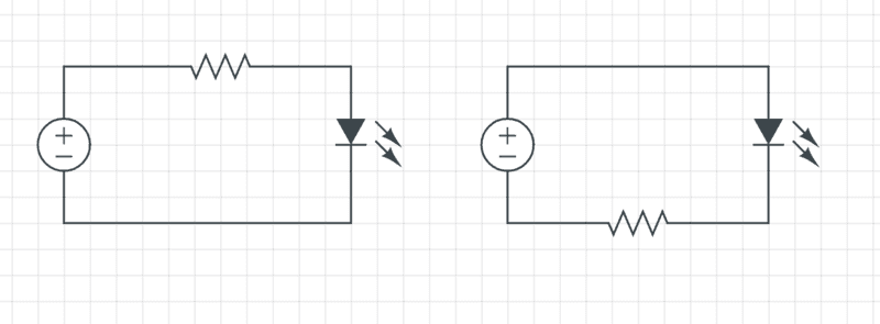

When putting an LED in series with a Resistor do you put it according to current convention (positive to negative) or to the actual current flow? Does it matter?

What is the role of the resistor, and will its position in the circuit change the way it works?
The two diagrams you have shown are absolutely identical in every significant respect, and that would be true regardless of what element was in the place where you show the diode. If you don't understand that, then you seriously need to get back to basics before trying to go further.
I have only studied Circuit Analysis with Resistor networks and now beginning to get into RC/RL Circuits so I don't really have an idea how circuits function in reality with my current knowledge, heck I don't even know fully what an LED is. This is something I google about out of my own spare time to understand more about circuits.
Anyways... But wouldn't you want the resistor being the first thing to take in the current BEFORE it hits the diode instead of AFTER it hits the diode?

Then I say again, you need to go back to basics. You are getting ahead of yourself and trying to learn in a very scatter-shot way. Not a good idea.
When you get back to basics you will realize that it it utterly irrelevant and in fact your question doesn't even make any sense.. The current in a series circuit goes through everything at the same time.
