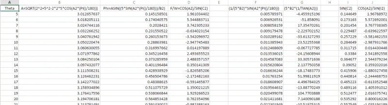

My plot didn't come out correctly, so I know I did it wrong. Where did I go wrong or was I even close?
1. Homework Statement
The hydraulic car lift shown in Fig 1 will be used to lift a vehicle of weight W. Determine the force in the hydraulic actuator required support the vehicle as a function of angle θ and the weight of the vehicle, W. Neglect the weight of the components of the lift as they will be negligible with respect to the weight of the vehicle. Assume that the weight of the vehicle is centered between points B and C.
Generate a plot of the ratio of actuator force to vehicle weight (F(actuator)/W) as a function of θ in the range 5 ≤ θ ≤ 60 degrees. If the maximum force the actuator can apply is 24 kip, determine the minimum value of θ that a 4,000 lb vehicle can be lifted from.
The attempt at a solution
sinφ/5 = sinθ/A is good. F/W = cos θ/sinφ is good. What's sinφ?
I'm suppose to plug all of this into excel and make a plot with a line curving with θ being between 5 ≤ θ ≤ 60 degrees.
My idea was this:
Plug in θ and get A
A^2=2^2+5^2-2(2)(5)cosθ
Then I'll plug in both θ and A to get Phi.
φ=arcsin[(5sin(θ)/A)]
Then I'll plug θ and φ
F/W = cos θ/sinφ
But when I do that on excel, I don't get a curved line. I get more of an up and down line.
This is what I used in the cells with A2:A57 having the numbers 5 through 60.
=sqrt(2^2+5^2-2*2*5*COS(A2*(180/PI())))
=ASIN((5*SIN(A2*(180/PI())))/B2)
=COS(A2)/SIN(C2)

Rearrange the first equation, sinφ/5 = sinθ/A to isolate sin(phi) --- plug that into F/W = cos(theta)/sin(phi).
That's what I did.
A=sqrt(2^2+5^2-2(2)(5)cosθ)
should there be a parenthesis between 5 and sin?
F/W = cosθ/sinφ
Unless I'm typing it wrong in excel
A2=5
B2=sqrt(2^2+5^2-2*2*5*COS(A2*(180/PI())))
C2=ASIN((5*SIN(A2*(180/PI())))/B2) should there be a parenthesis between 5 and sin?
D2=COS(A2)/SIN(C2)
sin(phi) = (1/5A) sin(theta); F/W = 5A cot(theta).

Did you know that anytime you put something into excel it puts you into radians mode? Opps! I did see that you made that correction for Excel. sorry.
I tried 3 ways and I still don't get a good curve.
