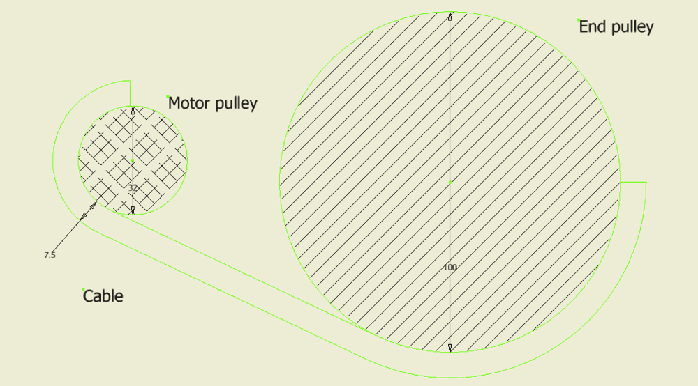

I need to transmit motion between a servo motor and a pulley through a cable. In order to do that, I've screwed a pulley to the servo and fix the cable on both the motor pulley and the pulley. I am working in a scale where the radius of the cable cannot be neglected due to a precision requirement. I actually don't know with which information I am supposed to used in order to calculate the rotation ratio of this system. I'm was thinking that the maximal radius, the combination of the pulley and the cable diameter, was the emplacement where most of the tension seems to be applied on the rope, thus I've used this value on both pulley to find the ratio. Some experimentation proven me wrong. Does someone know how to solve this kind of problems?

Personally I would make all calculations by treating the cable as a zero-thickness line, in the centre of the cable. so take whatever it's resting on and add half the diameter of the cable to the radius. where the cable bends, the inside is compressed and the outside is in tension, so the average on the centre remains the same.
IE, if you want the radius of the cables position, you would add the radius of the wheel to the radius of the cable, this is the distance of the centre of the cable to the centre of the pulley. IE, 5+(0.75/2) = 5.375mm.
If you can provide a quick sketch of how the system is laid out, ideally with measurements, then I'm sure you will get some answers. I'm struggling to work out what I'm supposed to be answering!
Here is the schematic of the system. It is the first time that I am using inventor to draw, thus I must apologize for the quality of this one. This draw have dimension that are 10 time the original one and these are millimeter.
243725

-Yes, the bigger pulley is just 0.4".
-The pulley is effectively turned by the servo. It is attach to its horn. I also want to find where is the tension applied in order to use this application radius for my rotation ratio calculation.
Another detail, the other end of the bigger pulley is attach to an elastic, which is acting as a tension spring.
I will try measuring from the center of the cable and test this once I'm done printing a new test bench.
After some experimentation, it seems that using the sommation of both the cable and pulley radius is effectively an excellent estimation, Since I only obtain value that are very close, I think that it is confirm, even if I did not take a lot of measure.
